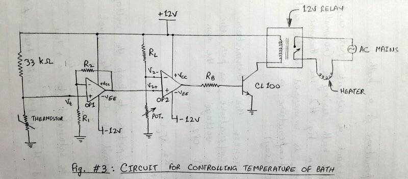

As part of our UG curricula in Physics major, we have a practical in which we have to draw the calibration curve of an NTC ##10~\mathrm{\Omega}## thermistor, and then construct a circuit to maintain the temperature of a water bath.
The calibration curve of our thermistor. The Prof. said that this is more or less fine.
The circuit, shown below, uses two LM741 Op-Amps. The first Op-Amp is a non-inverting amplifier, which amplifies the voltage ##V_t##, the potential difference across the thermistor. The second Op-Amp acts as a comparator.
We have used ##R_1 = 2.2~\mathrm{k\Omega}##, ##R_2 = 22~\mathrm{k\Omega},## ##R_L = 5~\mathrm{k\Omega},## ##R_B = 15~\mathrm{k\Omega},## and a ##1~\mathrm{k\Omega}## potentiometer.​
Suppose we want to create a temperature controller at 63°C. First, using the calibration curve, we find the potential difference (##V_t##) across the thermistor at this chosen temperature. The voltage at the output of Op-Amp 1 will be ##A_v V_t##, where $$A_v = 1 + \dfrac{R_2}{R_1} = 11$$ is the gain of the non-inverting amplifier. This voltage will be applied at the non-inverting input (##V_{2+}##) of Op-Amp 2. Next, using the potentiometer, we set the voltage at the inverting input of Op-Amp 2, ##V_{2-}##, to very close to, but slightly less than ##V_{2+}##. When switched on, the comparator is supposed to output either ##+V_\mathrm{sat}## or ##−V_\mathrm{sat}## based on the differences in the input. This voltage will be applied to the base of the transistor CL-100, which will turn the relay on accordingly. The relay controls the electric heater which heats the water bath.
Simple enough? Yes, theoretically. We have been facing a really hard time for the last two days (nearly seven hours total) in trying to make this circuit work.
At first, we were not getting the required gain from the first Op-Amp. The Op-Amp output was just getting saturated. The Prof. said that it might be due to loose connections. We re-did the circuit today, and the gain was coming okay. But then, the second Op-Amp never gave a proper output. We checked voltages everywhere; things were getting erratic. The thermistor was voltage ##V_t## was not coming to the first Op-Amp, if it did come, the output saturated. If we fixed that, the set voltage at ##V_{2-}## floated away. The Prof. sat with us and checked everything; the circuit was perfect. But the voltages were erratic. He couldn't help us, and blamed us and on our patience.
We use a lot of banana connectors — connections to the thermistor, to the power supply and to the relay. The Prof. said that these were having loose connections as the wires were not soldered inside them. But the lab assistants won't solder. I will try to have a word with the HoD to see if I can bring the male banana connectors home for soldering.
Other than that, is there anything which we can check to troubleshoot? We will get just one more day for this.

The input offset voltage of a 741 is very large (1+ mV) W.R.T. your thermistor voltage. That may not be your only problem, but it's definitely one of them.
Likes Wrichik Basu and berkeman
Did you check whether your CL100 BJT is still functional? Your circuit will reverse bias the emitter-base junction of that BJT when the output of the second op-amp goes negative. Reverse biasing the emitter-base junction of a BJT usually destroys it.
Likes DaveE, Wrichik Basu and dlgoff
First thing I would do is add a bunch of bypass capacitors to that circuit. One at every IC power pin to ground, as close as possible. Also a capacitor in parallel with R2 and the thermistor. Something like 0.1 - 0.001uF. This is a DC circuit, you don't want anything to oscillate. Theoretically, you don't need any of these. In practice, you might, especially with your long PS leads.
Also, you MUST put a clamp diode across the relay coil to give the coil current a path to flow when the transistor turns off.
Banana plugs will make good enough contact, soldering them is a waste of time.
Can you show us a picture of your circuit? Construction details can be important.
As @Dullard said, the 741 isn't a great choice for the first stage, but it should work better than what you've described. The offset voltage will make long term stability and temperature stability a problem.
Finally, your Prof doesn't know what he's talking about, circuit-wise.
Likes Wrichik Basu and hutchphd
All the above, plus;
The relay drive transistor will be dead by now. It requires a signal diode across the base-emitter to conduct during negative drive, to prevent break-down of the base when more than -7 volt reverse bias is applied. It also requires a power diode across the relay to catch the inductive flyback spike whenever the relay turns off.
Part of the problem could be the second op-amp being applied wrongly as a comparator. Op-amp inputs must be kept at very similar voltages, comparator inputs must be able to operate with big voltage differences.
That op-amp "comparator" has no hysteresis, positive feedback to make it switch cleanly like a Schmitt-trigger. There is no integrator, or low-pass filter capacitor, in the signal path to remove noise.
Yes, a good point about the transistor base diode. Do that too.
You should check the 741 comparator application by checking to see if the 1st stage output voltage exceeds the allowable common-mode range of the 2nd stage. It's in the data sheet, and I think it's a problem. But I'm too lazy to check instead of you. A resistive voltage divider will fix that but you have to adjust the thresholds accordingly. Otherwise op-amps can be used as comparators, it will work, but they don't do it well, as @Baluncore described. The slow or erratic switching might be hard on the transistor.

Also, not really related to your lab exercise, but good design practice would require a voltage reference to set thresholds, not the power supply voltages, they are noisy and unstable. One nice approach for this sort of circuit is a wheatstone bridge. But you'll just want to make this one (sort of) work and move on I think.

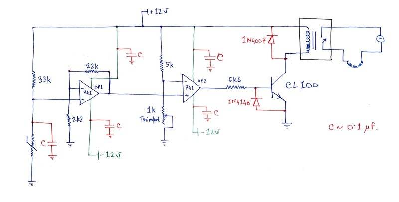

This diode should be connected with p-side to the emitter and n-side to the base, right? Also, will something like 1N5408 work, or should I use a schottky diode?
We are talking about adding two diodes.
1) Across the BE juction of the transistor. With the anode (p-side) at the emitter. 1N5408 will work but it's overkill. Actually nearly any (single) diode will work. I would use a small one, like 1N4148.
2) Across the relay coil with the anode at the transistor. 1N5408 is OK here, although it's larger than you need. It only has to carry the coil current on a transient basis when the transistor turns off. It will never see much more than 12V. It will never see more current than the relay coil has (whatever that is).

Will add this diode. This diode should be connected with p-side to the emitter and n-side to the base, right? Also, will something like 1N5408 work, or should I use a schottky diode?
There are two diodes needed in this case, and replace the CL100.
1N5408 across the relay, reverse biased, cathode 'bar' to +12V, with anode to the collector of CL100. That catches the reverse spike.
1N4148 or 1N914 (or 1N5408 etc if that is all you have), reverse biased, cathode 'bar' connected to the base, anode to the emitter. That prevents negative base breakdown.
Rb is 15k which limits base current to 1 mA. Minimum current gain of CL100 is only 40, which implies less than 40 mA could get to the coil.
What current does the relay need? Usually more than 40 mA.
Replace Rb with something 2k2 to 5k6 to get sufficient current to switch the relay.

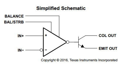

As @Dullard pointed out in post #4, the Input Offset Voltage of op-amps can be a problem. If the offset voltage of either stage is positive on its "+" input, then your circuit must supply a Negative correction voltage to that input. I don't see how that is possible with your present circuit.
Another option is to use use 741's with Offset Adjust inputs and null the offsets that way, read the Data Sheet or Application Notes for details.
We use the offset pins of LM741. Never thought about negative correction, though. Is this possible with the offset pins?

Ok, so I got hold of an 1N4148. Unfortunately, I found that I have used up all the 1N5408 diodes I had, but I do have some 1N4007, which I guess should work here (given that it has 1kV maximum repetitive peak reverse voltage)?
The 1N4007 will do as a flyback diode. When a flyback diode is used, the current is only momentary, the relay current, while the voltage is only the supply voltage or 1 volt during flyback. The only disadvantage of a 1kV flyback diode is the marginal extra cost in production.

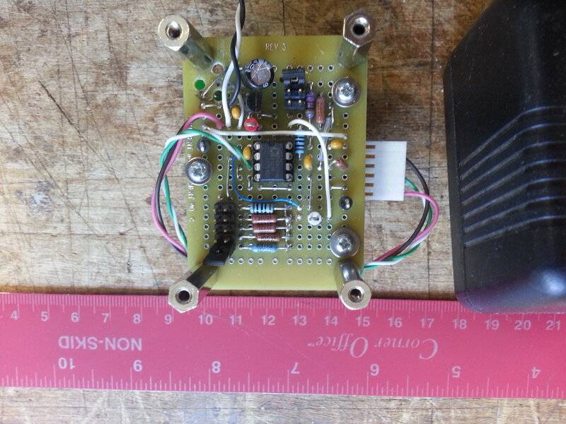

Here you go (3 images):

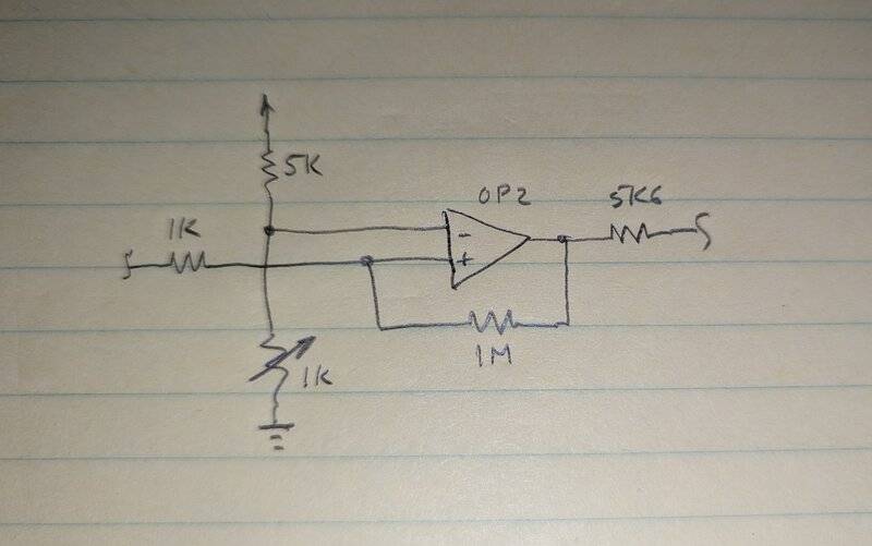

If you want to add some hysteresis to the comparator (a really good idea, IMO), you can just add two resistors, like this.
PS: Oops, probably too much. I'd make that 1K more like 100Ω which will give you ±1.2mV hysteresis at OP1 out, which is about ±100μV at the thermistor.

The circuit worked today.
Yes, there were ups and downs. Initially, the first Op-Amp was not giving the expected gain. But it did work fine after tweaking here and there. Unfortunately, however, I had set up the relay circuit in the opposite direction, so the transistor got excessively hot, and I literally burnt my index finger when I touched it.
On the brighter side, after replacing the transistor a second time, things started to work out. The β of these two new transistors that I bought yesterday were nearly 198-200. Using the trimpot over a potentiometer was a great idea because we could get variations in the voltage ~ few mV. We didn't have to implement the offset null arrangement.
Later, we felt that our breadboard was a bit faulty, but we could get decent readings and concluded the experiment.

The best version would be a comparator, like LM311, LM339, etc. with some positive feedback as I sketched before.
I was going through the datasheet of the LM311, but failed to see its advantage over a good op-amp with a transistor. This is the schematic of the LM311:
At the end, it's basically an op-amp with a transistor in a single package. Maybe a goof op-amp, much better than LM741. And maybe will result in less wiring. But other than that, what's the advantage of these over regular op-amp + transistor circuit?
Comparators are basically op-amps without the internal dominant pole frequency compensation. This compensation lowers the gain at high frequencies to make them inherently stable. However, it also slows them down. The LM311 can switch from -15V to +15V in 115nsec (slew rate = 260V/μsec). The OP07 has a slew rate of 0.3V/μsec. So it's much slower, both in switching and the delay to get to the active region of the next stage. This means that the inputs stay in/near the linear (active) range longer for the op-amp with positive feedback. In some designs you can eliminate the external positive feedback because of this, although I would usually include it, especially for slowly changing inputs.
Many comparators also have stronger output stages to drive more current which helps with capacitive loads, although the LM311 isn't a great example of that.
However, with external positive feedback in a slow application like yours, I don't think there's much wrong with using an op-amp. You'll see people do this when they want parts commonality for low cost or size. Like with a dual or quad op-amp IC. If the designer knows the difference and the consequences, I think it can often work well.
You are correct that the extra gain of the transistor makes this less important.
Wrichik Basu said:
Then how do you power the op-amps?
You choose one that works well with a single power supply. Even the LM324 does, which is ancient. Although there are better, newer versions, like rail-to-rail versions. There are some issues that you need to pay attention to with single supplies and/or low voltage operation though.
https://www.ti.com/lit/ml/sloa030a/sloa030a.pdf?ts=1680287582984
Same for comparators, BTW.
