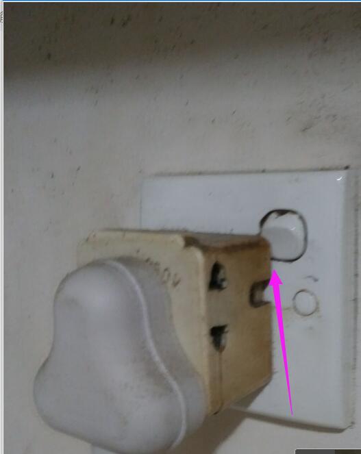

Hi, like this, I've just taken a picture. Is it fine? It's an air conditioner, it works, but don't know if it's a problem...

That "Could" be a problem. The danger is with the handle not moving all the way, the electrical contacts inside the switch may not be making very good electrical contact.
If this happens the switch will overheat and fail. It will also reduce the voltage to the air conditioner before it fails completely and may burn out the air conditioner motor.
It is better to find a smaller adapter as @Baluncore said, but you could try to file down (remove some material) from the corner of the adapter. If you see metal when you remove the corner, then do not use the adapter because it will not be safe. Buy a new adapter.

The picture shows an "ON" situation. When it's pressed down, it's OFF.
It's an air-conditioner. I've used like this for years. Since Last year, my air conditioner sometimes doesn't get cooled. I am thinking if the problem was due to this. Any comment? Thanks !

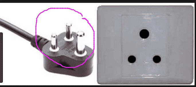

Hi all
My electric appliance has a plug like this (picture below)

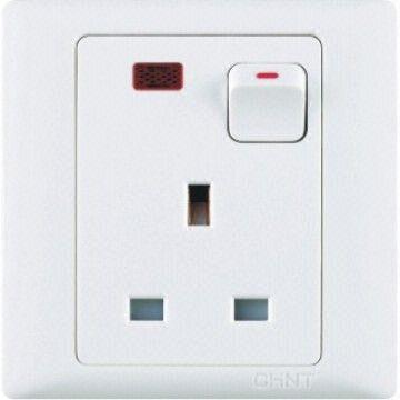

but my wall socket is like this (picture below)
british-standard-bs-socket-outlet-3-pin-switched-socket-13A-round-pin-with-neon-15A-250V.jpg
What is the keywords of adapter I should use?
tool store nearby said they didn't sell it anymore
Looks like some very old style socket. These cheap switches usually has a limited lifetime anyway, and even without molesting them the described way they tends to provide unstable contact with time (dangers were already described above).
Also, that adapter-like thing actually has holes on them??
I would prefer you buy a proper 'switched cbi wall socket' (google it!) and get somebody with a certificate to replace the socket.

From the photos and explanation you provided, the way you have it now looks OK to me! The adapter is holding the switch On.
