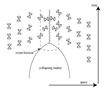

Idealistic solution for non-rotating BH includes a "white hole part"
However, realistic solution is different

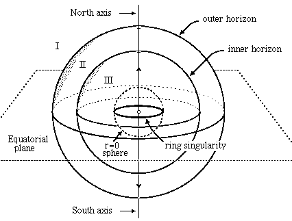

For the rotating BH we have an ideal solution with an "eternal" ring singularity inside, which can't be realistic, as ring, as I said, is "eternal" and there is no transition of collapsing matter into that ring.
So for the rotating BH we I know only the "idealistic" picture.
