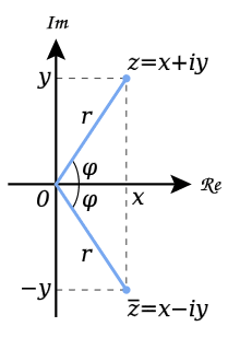

The imaginary plane is a plane for which the [itex]``x''[/itex] axis is a real number, and the [itex]``y''[/itex] axis is an imaginary number. It may help to have a picture, so I'll "borrow" one from Wikipedia:
Typically we write a complex number as [itex]z = a + jb[/itex], where [itex]a[/itex] is the real part (plotted on the horizontal axis) and [itex]b[/itex] is the imaginary part, plotted on the vertical axis. In this plot, [itex]r[/itex] is the magnitude of the complex number and [itex]\varphi[/itex] is the argument. Their definitions are straightforward from the geometry.

It's the "complex plane" (sometimes called "Argand plane"). There are two lines in it called "the real axis" and "the imaginary axis".
