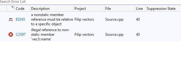

I have been studying overloading [ ]. I understand how it works from the book. I experiment using vector of structure and obviously I can't make it work. I wonder if it is possible to overload [] on vector of structure. Here is what I have and it's not even close to working, what can I do to make this work?
C++:
#include <iostream>
#include <vector>
using namespace std;
class VecA
private:
    struct Directory { char name[25]; int amount; };
    vector<Directory>Ivar(3);
public:
    VecA(int sub1, int sub2, int sub3) //constructor with 3 parameters of int
          {Ivar[0].amount = sub1; Ivar[1].amount = sub2; Ivar[2].amount = sub3;}
        int &operator[](int position){  return Ivar[position].amount;}
int main()
{    VecA anil(1, 2, 3);
    cout << anil[0] << ", " <<anil[1] << ", " << anil[2] << "\n\n";
    return 0;
In the code, I try to return Ivar[position].amount, it flagged me. In fact, it flagged me to put vector<Directory>Ivar(3) inside the class definition.
Is it possible to make this work?
Thanks

Your original code for the operator,
C++:
int& operator[] (int position) { return Ivar[position].amount; }
works fine for me, after fixing your other error.
Your real problem is in trying to declare vector<Directory> Ivar(3); as a member of class VecA.
(Aside: When you have several compiler errors, it's always a good idea to tackle the first one first. Errors early in the code can trigger apparent errors in later code that's actually OK.)
I totally understand why you tried to do it this way. When you declare an array of three Directory's and a vector of three Directory's in the body of a function, you do this:
C++:
Directory ArrA[3];
vector<Directory> VecA(3);
It's natural to assume that because you declare an array same way in a class definition, you can do likewise with the vector. Unfortunately, that doesn't work, because the "declaration" of the vector above isn't a pure declaration. The "(3)" invokes a specific non-default constructor of class vector. In the context of a class definition, you have to do that in a constructor for that class.
Filip showed you one way. I'll show you a couple of other ways that might be easier to follow, but might have disadvantages in efficiency or whatever, compared to his method.
Both methods (and Filip's) declare the vector as simply vector<Directory> Ivar; i.e. as an "empty" vector with zero length to start with. Now let's focus on your constructor for VecA, which has to fix the size of the vector.
Method 1: resize the vector in the body of the VecA constructor:
Add the statement Ivar.resize(3); at the beginning of the constructor. I think you can do this yourself. This method uses the default vector constructor to create an empty vector, when the VecA constructor starts up; then resizes the vector to the desired size.
Method 2: Use the VecA constructor's initializer list:
C++:
    VecA(int sub1, int sub2, int sub3) : Ivar(3)
      { Ivar[0].amount = sub1; Ivar[1].amount = sub2; Ivar[2].amount = sub3; }
The initializer at the end of the first line invokes the appropriate vector constuctor on Ivar directly, before any of the code in the body of the VecA constructor is executed. This is a bit more efficient than the first method, because it sets up the vector in one step (construction) instead of two (construction and resizing).
