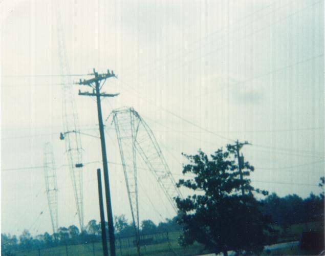

The basic structural idea seems to be to design the top half as a free-standing tower, on top of a "platform" supported by guy ropes with the bottom central "leg" in compression resisting the guy rope tension. http://en.wikipedia.org/wiki/Blaw-Knox_Tower
For a tall mast, that would have the advantage of reducing the length of the guy ropes compared with attaching some of them at the top, but the disadvantage was when this happened ...
