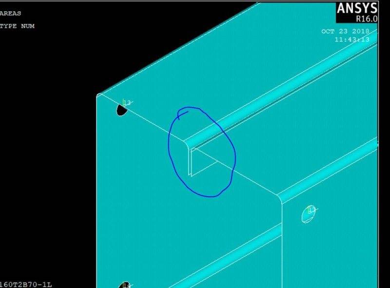

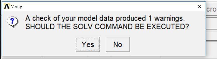

Hi,
I am facing issues with my program. Listed below. This is form my masters project. Also in what way can I connect the filleted surfaces shown in fig by a weld or just load or stress transfer connection.
Code:

/SOLU
PSTRES,ON
SOLVE
FINISH
