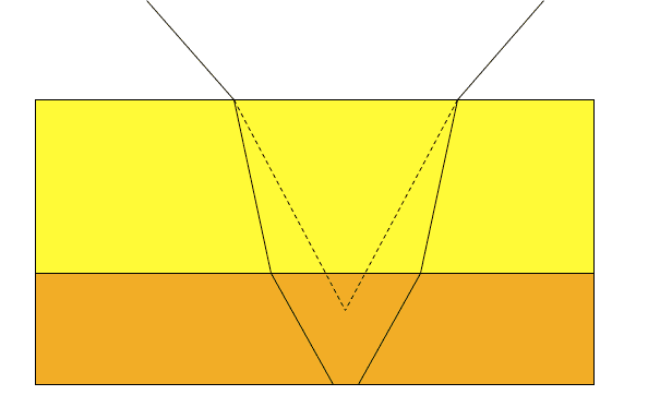

How can your write an equation for in slope-intercept form when you have no other numbers besides depth? I'm not really following. I understand how the rays are to be drawn but not how to get the equations from that drawing.
You actually have more numbers than just depth, but you choose some of them. You have the indices of refraction, that are given, and you choose the angles of incidence to examine. But you shouldn't be plugging numbers in anyway; this is a derivation. Leave everything symbolic until the end.
I can't see the png file that you attached. Anyway ...
What I would do is assign the x-coordinate to the depth, and the y-coordinate to the horizontal (and turn the picture sideways if it makes you feel better). I would set the surface of the benzene to x=0. Then, from the point on the bottom to the first boundary (in the water), you can calculate a Delta y using trig and the fact that you know the depth of the water. You can calculate an additional Delta y in the benzene in the same way. The sum of these two Delta y's gives you the y-intercept of the ray in air (since x=0 there). You can find the slope of the ray in air using trig and Snell's law. Do this for both rays. Then find the value of x where the two lines intersect. This point will not be on the physical rays; the rays are extrapolated back into the material.
OK, now I can see your image file. You have two bent ray paths represented by solid lines. Then, you have two dashed lines that look almost like extrapolations from the rays in the air, except that they look slightly bent at the boundary. Was this intentional? The dashed lines and the rays in the air should be colinear. Also, you should choose the same point on the bottom for both paths.
