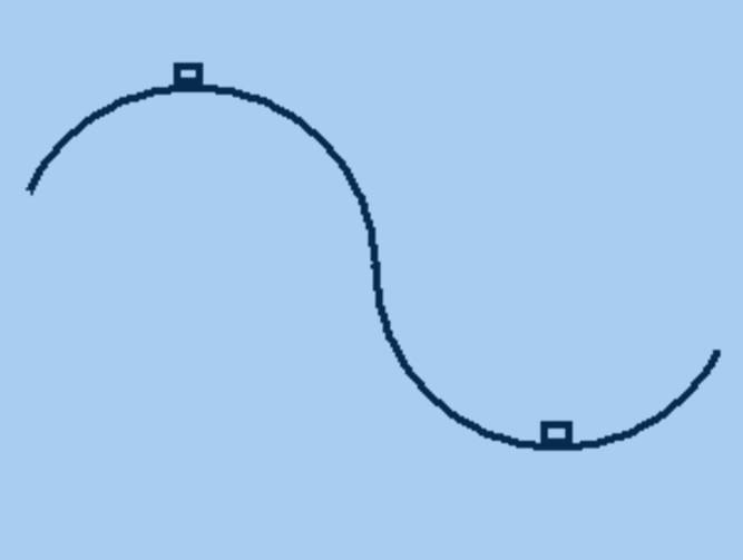

A roller coaster goes over the top of a semicircular track of radius R with a velocity Vtop, such that passengers momentarily feel weightless (zero 'g') at the top. The rollercoaster then accelerates to the bottom of another semicircular track of the same radius R. What effective 'g' do the passengers feel at the bottom? The difference in height between the top and bottom is 2R. (picture attached)

I am kinda confused as to how to solve this problem. I am also not entirely sure what they are asking or what my answer should look like or be in terms of. It looks like one of those problems that you solve using conservation of energy where I could make y1 = 2R v1 = Vtop, y2 = 0 and v2 =??, but since they didnt give any information on friction and this type of problem wouldn't give me any info about 'g' I am going to guess I need to use the law of universal gravitation, but I don't really know how to start.
My intuition would tell me that i should use the acceleration for circular motion formula (mv^2/r) with v as vtop and set it equal to -g. Maybe then i can solve that equality for vtop and at that point wouldn't it just be a conservation of energy problem to find the velocity in terms of g at the bottom? I am lost please help :(

ok, so this is what I now have so far:
the forces on the car at the top of the first hill:
[itex] FN-mg=ma [/itex]
[itex]FN=ma+mg [/itex]
In order for them to experience weightlessness they must be in free fall so the net acceleration must be zero which mean that a must = -g. This means that:
[itex]-g =\frac{Vtop^2}{R} [/itex]
[itex] Vtop^2 = -gR [/itex]
Now using E = K + U:
[itex] \frac{1}{2}Vtop^2 + g2R = \frac{1}{2}Vbottom^2 [/itex]
[itex] Vbottom = (Vtop^2+2g(2R))^\frac{1}{2}[/itex]
plugging in the value we got earlier for Vtop^2:
[itex] Vbottom = (4gR-gR)^\frac{1}{2}[/itex]
[itex] Vbottom = (3gR)^\frac{1}{2} [/itex]
How is this?

so could I rewrite it as
[itex] mg-FN=ma [/itex]
then
[itex]mg = ma + FN [/itex]
[itex] FN= mg-ma [/itex]
so a=g
[itex] vtop^2 = gR [/itex]
plugging that in instead the answer would be
[itex] (5gR)^\frac{1}{2} [/itex]

ah right... so the effective 'g' would be the net acceleration at the bottom of the track? so
[itex] abottom = \frac{Vbottom^2}{r} = \frac{5gR}{R} =5g [/itex]
so the effective g would be 5g?
No. You are forgetting about gravity.
That is the acceleration at the bottom of the track. The "F" in F=ma is the net force. There are two forces at play here, gravitation (directed downward) and the normal force (directed upward). These combine to yield the net force. You only feel non-gravitational forces. What must the acceleration due to non-gravitational forces be if the net acceleration is 5g upward?
Ok I'm sorry haha i think i got it this time. So at the bottom of the track:
[itex] FN- mg= 5gm [/itex]
[itex] FN=6gm [/itex]
[itex] a = 6g [/itex]
so you would feel an effective 'g' of 6g?
or wait a minute am i making the same sign mistake as before? If I chose acceleration for the system to be positive downward does that mean that at the bottom of the track
[itex] mg-FN=5gm[/itex]
but then again would that also make the 5gm be negative since its pointing upward and id end up with 6g anyway?
6g is the correct answer.
At the top of the track, the roller coaster must be accelerating downward at 1g in order for the sensed acceleration to be zero. At the bottom of the track, the roller coaster is accelerating upward at 5g. That means the sensed acceleration is 6g.
