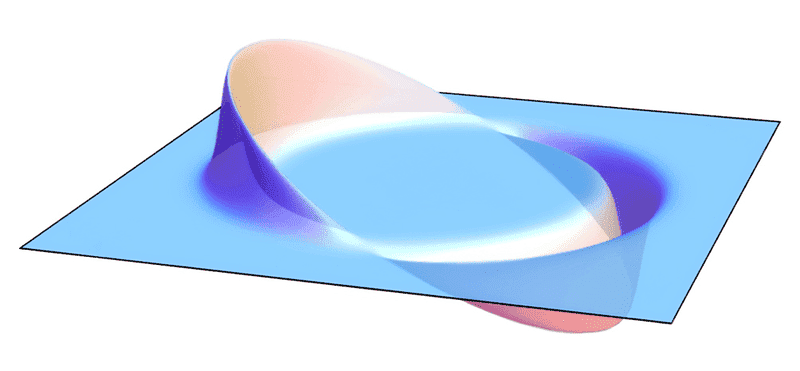

I guess what I'm really thinking about, more than how the observer would see it, is whether the volume elements in the center are contracted compared to the area completely outside the warp bubble. The image here represents the rate of "expansion" that is happening for different spatial points in a constant time hypersurface. Looking at the front, the rate of shrinking gets bigger then gets smaller and then disappears, which suggests to me that the volume remains contracted until it passes through the rear expanding zone. Sorry if anything seems vague, I'm just trying to keep the post short.
How do you compare spatially separated volumes? Isn't volume a summation of local measurements? According to the integral calculus it is!

I suggesting you think about what "the volume a distant observer sees" could possibly mean. If you look at a distant house it may look tiny, but that doesn't mean anything. What process are you proposing for a distant observer to measure the volume?

We are asking you to stop tossing the word “volume” around until you have paused to consider what a slippery concept it is in a curved spacetime. We calculate the volume of a region by integrating infinitesimal volume elements across the entire region…. But this integration requires that we evaluate all the volume elements at the same time, and there is no unique and non-arbitrary definition of “at the same time” in a curved spacetime.
