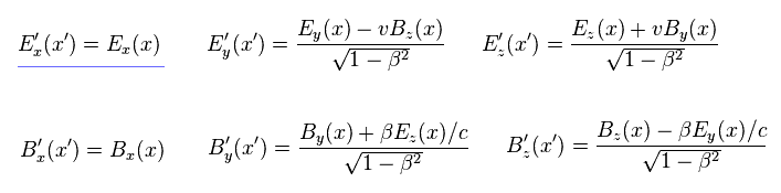

Are these two sets of transformations considered identical, or is there a slight difference?
They don't look identical, do they? The second one specifies that the fields being transformed are functions of ##x## (or ##x'##); the first doesn't say anything about what they are functions of, but it is implicit that we are transforming the fields at a particular event (point in spacetime). So without knowing what ##x## (and ##x'##) represent, how can we know whether the two are identical?
I think our confusion stems from the fact that we were on different wavelengths regarding which set of transformations we were supposed to discuss. For this I am partly responsible, and I apologize once again.
As I mentioned earlier:
tade said:
Note that the image posted in that thread has the fields as a function of (x) and (x'). That wasn't my intention, but was in the image I plucked from the net. I'm still thinking about the question I posed in #31.
I meant to use the top set instead of the bottom set. Dale has answered my question for the bottom set, which I did not want; what's the answer for the top set? My objective is to answer the question I posed in #31.
In your post #31 in the other thread, you referenced the bottom set, not the top set.
You might want to take a step back at this point. If you are trying to figure out how Lorentz transformations act on E and B fields that describe spherical wavefronts, your first step should be to find expressions for the E and B fields, as a function of the coordinates in a given inertial frame, that describe spherical wavefronts. (Which actually don't exist, as someone pointed out in the other thread: that is, there is no spherically symmetric solution of the source-free Maxwell Equations. But you might merely be interested in, say, a solution describing omnidirectional radiation from an antenna, which will not be exactly spherically symmetric.)
Also, you might observe that, in both of the sets of transformation equations you gave, there are no derivatives of the fields; only values of the fields at the chosen point. So to apply the transformation at a single point of spacetime, you actually don't even need to know how the fields vary with the coordinates. But you probably are interested in how the transformation acts at multiple points of spacetime.
