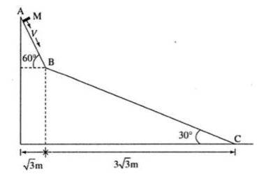

A small block of mass M moves on a frictionless surface on an inclined plane, as shown in the figure. The angle of the incline suddenly changes from 60 to 30 at point B. The block is initially rest at A
$$ \frac{mv^2}{2} = mgh$$
momentum conservation
So, what I did was suppose the mass of ramp is $ M_r$ and let velocity at B of block be v, then, after inellastic collsion both bodies v' velocity
at B ,
$$M\vec{v}= M_r \vec{v'}+ M \vec{v'}$$
or,
$$ \frac{M}{M +M_r} \vec{v}= \vec{v'}$$
Now,
Suppose I take the limit as mass of ramp goes to infinity, then I get $\vec{ v'}=0$
that means, after the collision, the block is temporarily at rest and then slides to ground.So, we can just neglect upper half and do energy conservation in lower half ramp to get velocity at final position.
However, my answer came out wrong for some reason, I wish to ask if my concepts are correct?
answer I got:
$$| v|= \sqrt{60}$$
actual answer:
$$| v|= \sqrt{105}$$

The answer you refer seems the speed just before the ramp C. After the ramp C the block goes horizontally with reduced speed by factor of ##\frac{\sqrt{3}}{2}## as well as at ramp B.

"The angle of the incline suddenly changes"
The thing about sudden impacts is that although the duration is brief (and in general unknown) the forces can be very large and unknown. So the integral of the force over the duration, i.e. the net change in momentum, can be significant.
To make @PeroK's point more starkly, what if the first ramp were vertical and the second horizontal?

If the first ramp were vertical and fhe second horizontal, what would you expect the velocity of the block to be after meeting the second ramp?
haruspex said:
You did not answer my question.
I would guess that it becomes zero. But maybe it may bounce as well hmm

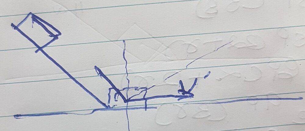

hmm I think I understand now, along normal the momentum not conserved but along surface it is. But one thing though, I still seek a more elaborate description of what exactly is happenign which makes this normal impulse not negligible in comparison to gravity in collisions

Let's see some analysis of the problem from you. Can you solve this using the velocity vector?
See my hint about modelling the collision in post #5.

I think I get the idea now,
$$ v'\sin \theta = \sqrt{2 gh}$$
is the final equation that I had got
here the $$\theta$$ is angle of ramp, I got this equation by finding component of velocity post collision parallel to ramp. And v' is the final velocity (i.e: velocity after it gets out of ramp)
Now that I have this, could you tell me how to describe the impulse which occurs to component perpendicular to ramp?

That doesn't look right.
The idea is that the object loses all its momentum in the direction normal to the ramp it collides with and none of its momentum in the direction tangential to the ramp it collides with.
Therefore, you have to calculate the components of velocity (normal and tangential to the ramp) at the time of collision. The velocity after the collision is the tangential component only.
That's the idea. Now you have to do the calculations.
Hmm I did this by drawing a diagram after collision I'm not sure how the diagram would be right at collision. But I drew this
I can't figure out how to draw it right at collision, I'm thinking that it may chance of tipping over , how do I know if tips over or not? 🤔 🤔 🧐🤔🤔
In that diagram you really want to show the components of ##v## before the collision. And, especially how ##v'## relates to them.
You're not supposed to worry about the object bouncing or tipping over!

It's always worth running a sanity check. Does your expression give a sensible answer when the first surface is at right angles to the second?
You know that what is preserved is the component of momentum parallel to the second surface, so resolve the momentum before impact into components parallel and normal to the second surface.
