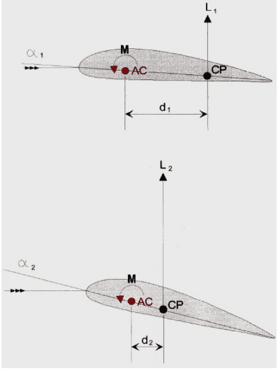

Hopefully, just to add clarity to my question, here another picture illustrating the lift force ##L## applied at the center of pressure ##CP##, which varies with AoA. If the pitching moment due to ##L## is calculated about the aerodynamic center ##AC##, the moment remains constant: even if the magnitude of ##L## increases from ##L_1## to ##L_2##, the lever arm ##d## decreases from ##d_1## to ##d_2## keeping the moment constant...

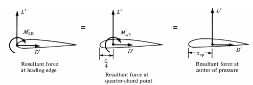

The second figure shows how the force can be moved to different points of applications causing the moment ##M## to change depending on the application point. But only when the force is applied at c/4 the moment remains constant with AoA.

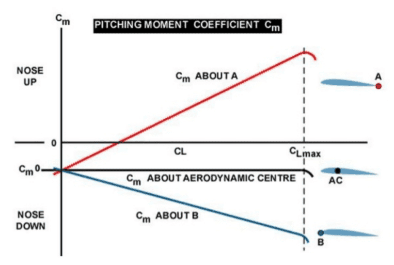

I found figure that may be useful for other readers like me. For the same aerofoil, the figure shows how the pitching moment ##C_m## is constant if the moment is calculated choosing AC as the reference point (lever arm is distance from ##AC## to the lift force ##L##). In other cases, the coefficient varies linearly with AoA:
"...Yes. In fact the definition of the aerodynamic centre is the point at which the pitching moment does not change significantly with angle of attack..."
