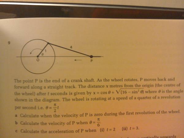

Colin2
I need help solving all three parts to this question, never seen a question regarding applications of differentiation that is this hard before!
All help is much appreciated.
