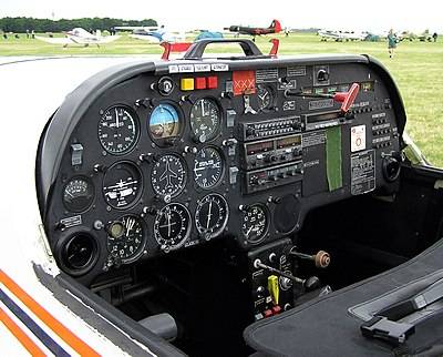

Have a look at the typical flight instruments that a pilot uses, and tell us which ones you think use a gyroscope and why you think that:
https://en.wikipedia.org/wiki/Flight_instruments

I guess that compass in aircrafts uses gyroscope.As the gyroscope provides a stable reference plane for the compass, allowing it to maintain a more accurate reading of the aircraft's heading.
I'm not sure but I guess that.
In that Wikipedia article, they refer to a "magnetic compass"... :wink:
EDIT -- what is the difference between that "Magnetic Compass" and the "Heading Indicator" instrument?

Magnetic compass and heading indicator both are used as direction indicators but the difference between them is that magnetic indicator use earths magnetic field where as heading indicator use the rotation of gyroscope (that provides stable
Reference point)
So heading indicator is more accurate than magnetic compass
O its means that heading indicator use gyroscope? 🤔
Am I right this time?
Likes berkeman
Yes, I think that's what they are saying. But note the part where they say that the Heading Indicator needs to be re-synchronized with the Magnetic Compass occasionally. What is the reason they give for that?

The point I understand is that the heading indicator get affected by the precession and then start giving inaccurate direction then pilot re adjust it in accordance to the magnetic compass.

The gyro compass is able to track turns very precisely making it much easier for the pilot to roll out on the desired heading after a turn, but over time the gyro will drift. The magnetic compass has the opposite characteristics, it reacts very sluggish during a turn but if suitably corrected for variation and deviation it will provide excellent heading after flying straight for a while. So standard procedure is to regularly set the gyro compass from the magnetic compass, especially before a turn.
And note there are also two other essential instruments that uses gyroscopes, in case you are interested in more applications of mechanical gyroscopes in in the cockpit.

The other two instruments are rate of turn indicator and artificial horizon, that use gyroscope. Am I right?

That is correct. The mechanical turn indicator is interesting because it can indicate yaw rate (of the airplane) with a single gyro and a spring. The mechanical artificial horizon is also interesting because, at least in earlier simpler designs, it is susceptible to what is called gimbal lock at certain attitudes (usually in near vertical attitudes).
