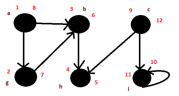

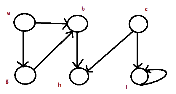

This is the example,at which I want to apply the algorithm:

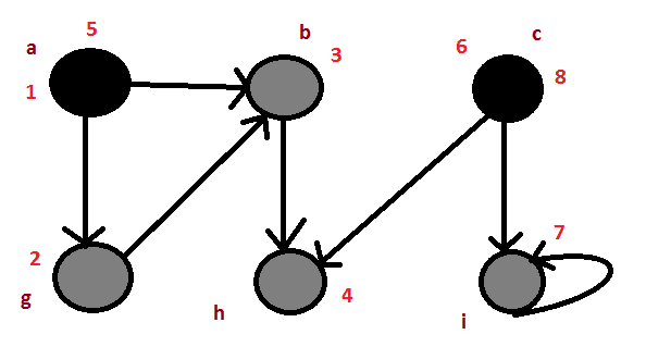

According to my notes,it is like that:

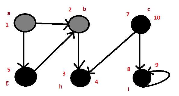

but..I found the following:
Could you tell me which of them is right? Have I done something wrong? (Thinking)

The book's solution is alphabetical, i.e. starts at node "A" and then proceeds to "B". Yours went from "A" to "G".
I don't think it really matters? It shouldn't if you've got the principle of it. I glanced at your code and it looks fine to me.

I think I have done some mistakes.. (Wasntme) I tried it again now.
After $a$,I started again with the node $g$ and now I got:
Could you tell me if it is right now? (Thinking)

Hey evinda! ;)
I believe you are right.
The final state is where all nodes are black.
The algorithm works by initializing all nodes to white.
Then each of those nodes is visited and traced to its neighbors.
When a node is visited, it is set to gray, and when all neighbors have been visited, it is set to black.
When all nodes have been visited, they are all black. (Smile)
I believe the state in your notes cannot occur.
Since $g$ is black, it has been visited.
This implies that all of its neighbors have also been visited and should also be black. But $b$ is not black. :eek:
