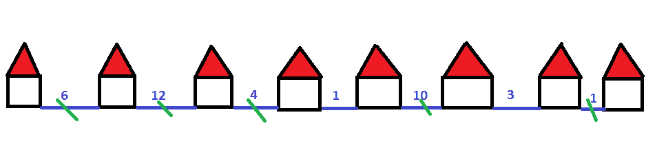

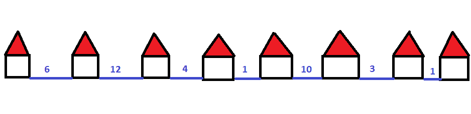

We consider a long straight road along of which there are some houses.
A mobile phone company wants to put antennas along the road for the service of the residents of the homes.
The range of each antenna is four kilometers.
Give an algorithm that puts the smallest number of antennas.Could we consider the road as edges and the houses as vertices?
If so, then could we maybe apply DFS and mark the 4th edge, then the 8th and so on? (Thinking)

So will we have for example such a straight line with houses?
If so, then would we put an antenna at the following green marked positions?
The antenna in the 12 km section will cover either no house at all, or only 1 house.
So this is not a useful antenna. (Worried)Since each house has to be covered, we can start with the first house and put an antenna 4 km beyond it.
This choice has the most possible benefit and an antenna will be required within 4 km of the house. (Thinking)
Then we can find the next house that is not covered yet and repeat the procedure.
We are free to shift the antennas backward a bit as long as they still cover the same houses.When we're finished we'll have a solution with a minimal number of antennas.
There can be other solutions, for instance if we start at the other end of the road, but since it will also be optimal, it will have the same number of antennas. (Mmm)

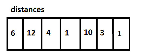

In our example, the input is the following, right?
We can place an antenna at the 4th kilometer, then at the (6+12)th kilometer, and then we don't have to put an other antenna for the next house. Then we put an antenna at the (6+12+4+2+1)th kilometer, then at the (6+12+4+2+1+10)th kilometer and then we are done.
Or have I understood it wrong? (Thinking)
First antenna should indeed be at 0+4=4, but the second should be at 6+12+4, covering 3 houses instead of 2.
Each antenna goes 4 km beyond the first house that is not covered yet. (Wasntme)
