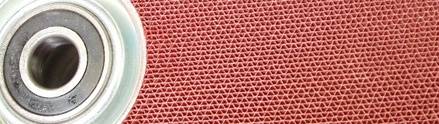

chemisttree said:
Try this.
Or this.
Thank you but I am not seeing any relevant (how its made) info on either of those links. I hope i didnt miss anything.
Did you read the patent? Column 2, lines 8-56, for example?
This picture on the Munters site should describe in enough detail what needs to be done.
Impregnated filamentous material means fiberboard or cardboard and excelsior means wood shavings. Incorporating silica into that occurs during its manufacture. A slurry of fibers and silica is poured out onto a screen mold and residual moisture is pressed out (like how you make paper) and then dried. That’s “impregnated” paper. From that paper a cardboard stack is made. From the cardboard stack is cut out a round shape and then it is fixed to an arbor.
You are going to have lots of trouble if you can’t follow bread crumbs like these...
  • Haha
Likes Tom.G
Thanks for your suggestion. Also a descant wheel is not an ERV wheel (which is why I specified I need to apply it to aluminum or a plastic capable of heat transfer). They do different things and are manufactured differently.
