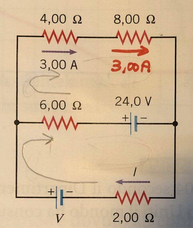

Calculate ##I## and ##V## in the circuit below
Kirchhoff's laws
##I=\frac{V}{R}##
For this one circuit, I've applied Kirchhoff's laws as following:
$$\left\{\begin{matrix}
V-6\Omega I_{6}-24V-2\Omega I_{2}=0\\
24V-6\Omega I_{6}-12V-24V=0\\
I_{2}+I_{6}=6A
\end{matrix}\right.$$
but the values I get for ##I## and ##V## aren't correct... what's wrong?

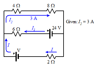

How did you get the last equation?
On your diagram, label your assumed current directions for each current you will be using in your equations. Apply those directions consistently for each equation that you write. Potential drops across resistors depend upon the direction of current flow!
Where did the 6 Amps come from in your third equation?

I got it from second Kirchhoff's law: current entering a node is equal to the current exiting that node.
What I wrote in the thread is actually wrong, in accordance with my chose of the current directions, It would be ##I_{4}+I_{6}+I_{8}=I_{2}##.
That is actually wrong, in accordance with what my choices are, the third equation should be: ##I_{4}+I_{6}+I_{8}=I_{2}##
By the way, with 6 amps I meant ##I_{4}+I_{8}##.
Have I done something wrong? In which way would potential drops in resistors depend upon the current flow?
The same current flows through both the 4 and 8 Ohm resistors. They are in series so there is only one current in that branch.
You need to draw in and clearly label the currents you are using before writing your equations so that you don't mistakenly change their directions (and hence potential drop directions) midway.
As for potential drops in resistors,
Note how the direction of the potential drop changes with the direction of the current.

Rather than assign individual currents to each component, you want to take advantage of the fact that series-connected components will always share one current. This will minimize the number of variables that end up in your equations. For your circuit, something like this:
So you work with "branch currents" rather than "component currents".
