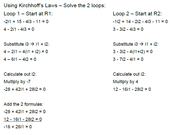

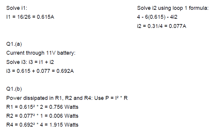

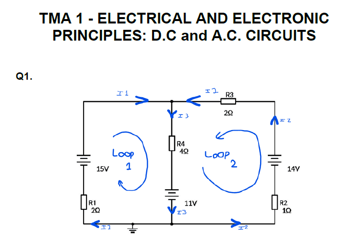

The question is from DC circuits:
Calculate the current through the 11V battery, and the dissipated power in R1, R2, and R4.
I have made an attempt at the question and would appreciate feedback before I submit please.
Kirchoff's laws.
P=I^2R
See my attached working out.
Thanks in advance
[Images of attached PDF pasted into post by the Mentors]
  • TMA1 - Q1.pdf
Likes Gavran
I didn't go through the detailed calculations, but it looks like your approach is okay. Can you back-annotate the voltages in the circuit and check yourself that way? Or another good trick is to re-solve the problem using KCL node equations to see if you get the same answers.
Likes EddieH and scottdave
OP, your traverse isn't consistent...
One thing you can do to check your currents: start at the bottom node (ground) and work through each path to the top and check that the voltage at the node at top middle is the same regardless of the path taken.
Likes EddieH and berkeman

The calculations and the method, both of them are correct.

Hi all,
Thanks for your input, it cheers me up knowing that not only am I using the correct interpretation of the laws, I somehow managed to get the correct answers.
And I was flapping to think I was bashing my face against the keyboard, course notes and google for nothing lol
:partytime:
Ed.

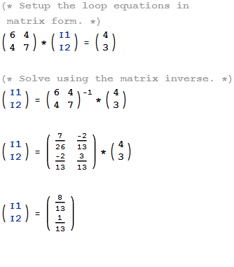

Babadag is showing how to setup the loop equations in matrix form using a text description.
Using standard linear algebra math symbols and using matrix inverse rather than Cramer's rule:
Likes Babadag and DeBangis21

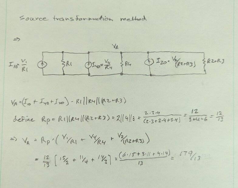

Yes, the right way for a computer to solve this.
OTOH, analog EEs will reduce this sort of problem with superposition and/or source transformations. Very few equations required, just some back of the envelope sketches.

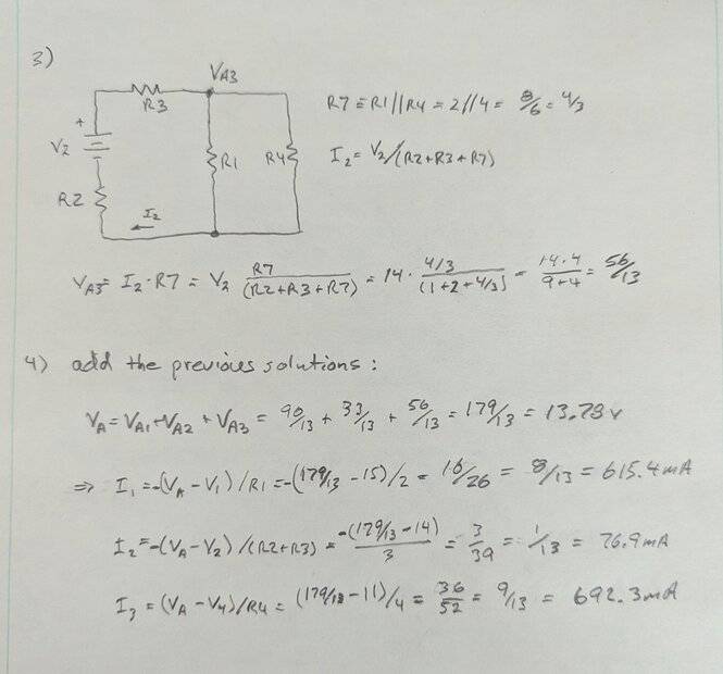

bob012345 said:
I tried this several times. It’s three times the work and I never got the right answers! I think it’s better to include the sources in the original loop equations.
There are several different methods to solve circuits like this. So EEs use the ones they are most comfortable with. You may need to practice other methods to become proficient. The "best" method depends on the problem, the methods you know, and your preferences.
The superposition method is shown below. It looks a bit laborious because I drew out every step. In practice we would do most of this in our head since each case is simply a voltage divider. Especially in this case since we can combine R2 and R3 and move the voltage sources all to the bottom which results in symbolically identical branches. You really only need to solve 1 case and then interchange the component names for the others (always look for and exploit symmetry if you find it).
I usually prefer source transformations, depending on the network, of course. That method looks like this. I've drawn this one the way I actually would in practice, skipping steps.
I usually prefer these more graphical transformations to purely algebraic solutions because shorter equations are less error prone, common terms often appear that make calculation easier, and (most importantly) you get a little insight into how the network works, not just what the answers are. This latter point is important in the real world of design where the process works in reverse; you know what you need and have to choose the network/values to achieve that.
For example, this network is part of the most common summing amplifier circuits and these methods yield the easy approach to understanding and designing them. So how hard would it be if I asked you to add a 6th input to the summer below, or increase the gain in channel 4 by 20% without changing the other channels? Would you have to start over, or just adjust a few things?
Your source transformation method didn't find I1, I2 and I3.
Really???
It's trivial once you know the voltages. I'd say it's left as an exercise for the reader, except that it's exactly the same as what I did in the previous example. I also didn't tell you that 179/13 = 13.78. I kind of lost interest at that point.
It's not a contest. You can do it the way you like. I'm OK with that.
PS: This does illuminate an important point in circuit solutions. Often you can (should) look at a network and try to identify the most important missing data, often the hardest to solve for. So, if you can say "if I knew that voltage (current, whatever), the rest of the network would be easy to solve". VA, in this example. Then it's often best to use the simplest method to just solve for those key parameters. Then you can go back to the original network and switch methods, or just do simple solutions for the others. This is especially important with source transformations because you often lose or obscure the other parameters when you simplify between steps. The idea is to first reduce the complexity of the problem, perhaps by splitting it into separate smaller problems, before you solve for everything. For big networks the rote KCL, KVL equations can get really big and unwieldly.
