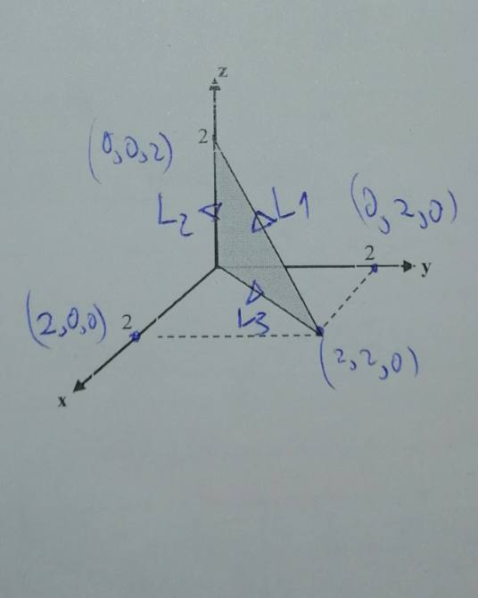

Test stokes theorem on v(s,φ,z)=(ssinφ)S-2zΦ+(2z-ssinφ)Ζ
My given surface has those points as x,y,z coordinates (0.0.2) (0.0.0) (2.2.0)
Its basically a triangle that one side is on the z axis, the other one is on the xy (x=y). The rotation is counterclockwise

In the first problem:
1) My first dl is super easy since only the z axis has "movement" from 2 to 0. x=y=0 so i only have dz
2) On the second dl I am moving from 0 to π/4 (if I am correct). z=0 and s=2*root(2) so i only have dφ here (is this right though or am i missing something?)
3) I have no idea what to do on the third one because my s changes as the z changes but i cannot find the relationship between the two
4) As for the da imi staying on cylindrical coordinates? If so what do i do? How do i determine the da and the points of integration?

Here is the drawing. First dl z goes from 2 to 0. Second dl s goes from 0 to 2root(2) third one is the L1 line but i don't have a clue on how to relate s to z and what i could use as points of integration. Now for the da i think that only Z is perpendicular. So i will have dxdyZ? I only have a x=y line left. How do i translate this to cylindrical and how imi getting my points of integration?
the da has to be perpendicular to the triangle at every point which unit vector
can you think of which is like this how will this triangle look like if you see it from z axis you shouldn't be able to see the height of triangle you only see a line what unit vector will be perpendicular to that line

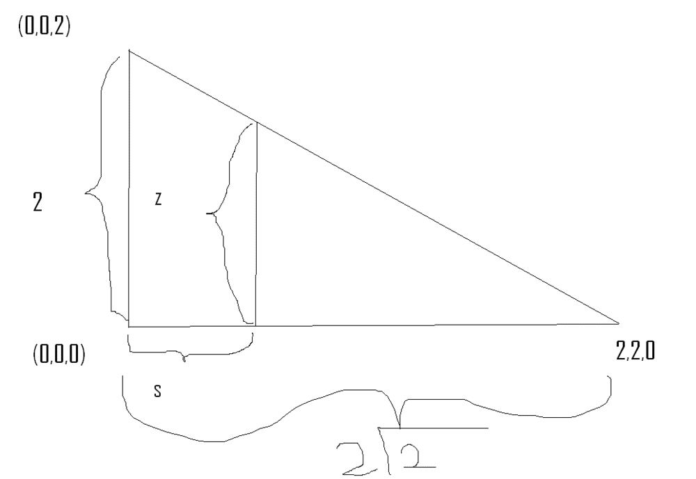

do you know why in line L2 if you do it in cylindrical there is no integral over phi but only over ds and dz then how can you relate them using similar triangles

Oh i think i see it now. The only one perpendicular to triangle is φ right? So i would have to have something like da = dsdzΦ right? Now i somehow have to find the points of integration (any tips on that?)

it is one way to relate ds and dz for the path l1 or you can use the angles you computed to relate z and s and thus dz and ds
how about for any random point on path l1 how would relate z and s?
I found z/s = root(3)/3 so dz= [root(3)/3]ds. So now i guess that if this is correct i can integrate either from z 0 -->2 or s 0 -->2root(3)

not quite right but how did you get ## \frac{z}{s} = \frac{\sqrt{3}}{3}##
and s goes from ##0## to ##2 \sqrt{2}##
I said that if z is l2 and s is l1, then l1=root( (2-0)^2 + (2-0)^2 + (0-2)^2) = 2root(3). And then the cos(οf l1l2) = root(3)/3. I feel a bit dumb now. It must be something so simple and for some weird reason I am not getting it
nah you are just being a little careless
yes
L_1 = 2\sqrt{3}
but this is not s
when you go from point (2,2,0) to (0,0,0)
your s changes from what to what
from 2root(2) to 0. But I am trying to find a relation with L1 and now I am computing L3
yes
lets say you are halfway up L1 what is s and z of that point
one and root2 i guess?
yes
now relate this s and z
245256
tan in the 2.2.0 point = z/s. I don't know how i missed that. I really thank you for your help. I love the fact that you don't give a simple answer but you guide me to the answer

wait no
tan in 2.2.0 point is ##\frac{z}{2\sqrt{2} -s}##
Likes satanikoskioftes
Ye my bad. The reason why its 2root(2)-s and not s-2root(2) is due to the fact that when z goes 2 the s goes 0?
it is just because s is smaller than 2 root 2
