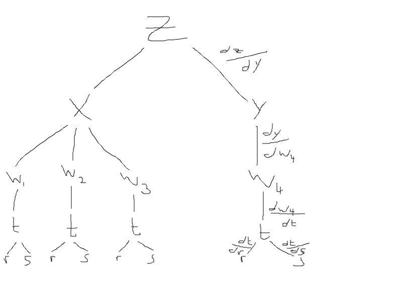

Write out a tree (this will be a big tree) of dependencies and hence write down an expression for
∂z/∂r
z=k(x, y)=xy2, x=(w1)(w2)+w3, y=w4;
w1=t, w2=t2, w3=2t+1, w4=sin(t);
t=r2+2s2
This is the tree I drew and followed the relevant paths in order to try and write and expression but my expression is to short. I only calculate 2 terms when there is suppose to be 8:
http://www.picpaste.com/Untitled_Image-OZCiTMvb.jpg
This is wrong however. I need 16 leaves at the base. What am I doing wrong?
∂z/∂r
t=r2+2s2
I drew a diagram and got the same one you did.
As far as your partial ## \partial z/\partial r## is concerned, I get four terms to your two. Three of the four terms look like this:
$$ \frac{\partial z}{\partial x} \frac{\partial x}{\partial w_i} \frac{d w_i}{dt} \frac{\partial t}{\partial r}$$
For the fourth one, the first factor is the partial of z with respect to y.
