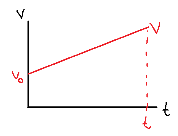

That formula is written wrong, it should use ##v_0## the veolocity at time t = 0, not ##v## which we often means the velocity at the time t. Also, the formula is only valid for constant acceleration.
whartung said:
To be fair, I've never really seen the v*t prefix to the formula before. I've always seen the 1/2at^2 part. I guess they always assumed the object was stopped, and never really talked about decelerating. Of course, it makes sense the the original velocity must be considered.
If something is starting at rest, then the "v*t" is zero, well it should read ##v_0t## as I mentioned above.
You are thinking a bit too complicated here I think. What if the acceleration is zero, and an object is moving at constant velocity ##v_0##? What would the distance traveled be then? Well you guessed it, it is of course ##d = v_0t##, a "special case" of the formula ##d = v_0t + at^2/2##.
Let's now consider how the distance traveled changes if you also have an acceleration. Let's take an acceleration that makes the object go faster and faster. It is clear that we would get a larger d now than with the case when a = 0.
This v-t diagram shows what is happening.
ok great, we know d will be bigger now than if a = 0. But can we calculate d for a non-zero a?
Consider the average velocity ##v_\text{avg} = (v_0+v)/2##. If the object moved with this velocity ##v_\text{avg}## as a constant velocity, it would travel the same distance is if was accelerating from ##v_0## to ##v## with the acceleration a. We thus have that ##d =v_\text{avg}\cdot t = (v_0+v)t/2##. But we also have that ##v=v_0 + at##, insert this into our formula for ##d## and we get the final formula ##d = (v_0+v_0 + at)t/2 = v_0t + at^2 / 2##
