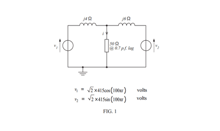

FIGURE 1 shows a 50 Ω load being fed from two voltage sources via
their associated reactances. Determine the current i flowing in the load by:
(a) applying Thévenin’s theorem
(b) applying the superposition theorem

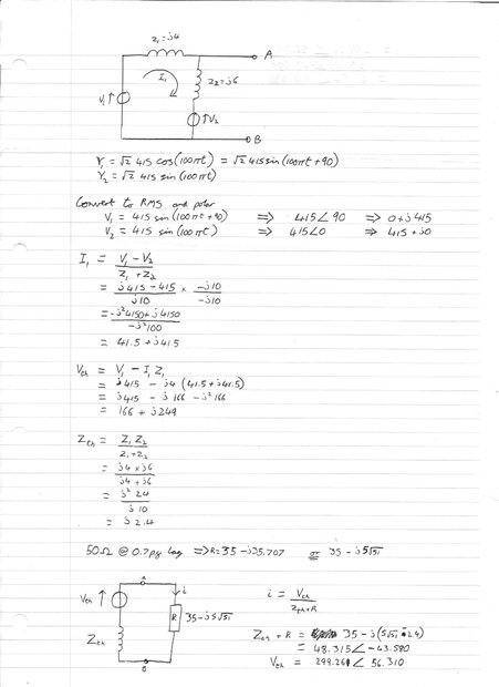

Thevenin equivalents, polar & rectangular conversions
So I've seen other threads on here with the same problem from a few years ago, and I'm just not getting the same answers. However, I followed along with a similar problem in the textbook and used all the same methods, so can't understand where I've gone wrong, or if I even am wrong. Also not sure if its ok that the current should be at an angle greater than 90 degrees
Likes arhzz

You have the sign of the imaginary part of the 50 Ω load wrong.
I thought a lagging power factor leads to a negative phase angle, and thus a negative imaginary component. Is that not right?
Likes mpar3
The Electrician said:
That is not right.
Look here: https://en.wikipedia.org/wiki/Power_factor#Lagging_and_leading_power_factors
Part way down the page under the heading "Lagging and leading power factors" you'll find discussion of the topic.
I don't know why I was so set on it being negative. I think I must have mixed it up with the angle between current and voltage maybe. Thanks for your help
