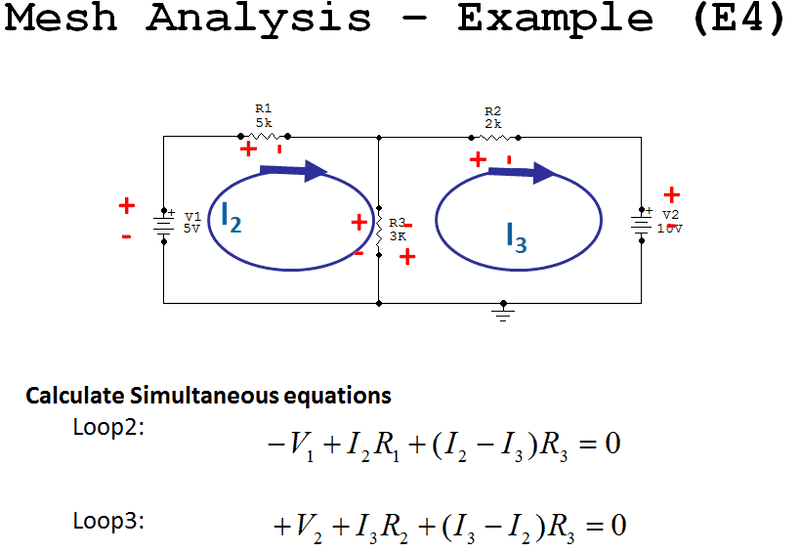

I'm really not sure what the proper way is to approach this problem. Kirchoff's current and voltage law confuse me. I've done abstract loop analysis in circuits before such as this example:
but we've never had to solve for any values. Also how is the current source I1 in the first picture treated in a loop equation such as the ones in the second picture?
So far I've come up with loop equations for the circuit. I think I can then get a solution for the currents with simultaneous equations and then calculate the voltage through R1 from that. My main problem is I don't know what to do with the current source I1.

Thanks. So can I simply change I1 and R7 to a voltage source with Ohm's Law? If I convert it to a voltage source though where in the loop would that voltage source be placed? Adjacent to Loop 4 thus giving me the equation : (I4-I3)R2 + (I4-I2)R5 + (I1*R7) or on it's own in Loop 5?
Essentially, yes. Technically it's the conversion of a Norton model to a Thevenin model.
I1 and R7 are snipped out of the circuit and put in their place is a voltage source of magnitude ##I1 R7## in series with a resistance value of R7. Loop 5 disappears.
