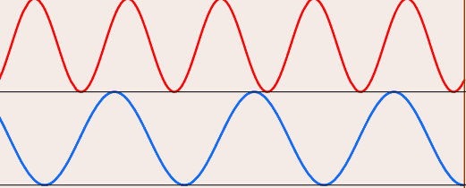

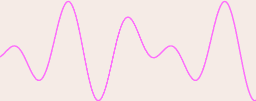

Hello everyone, sorry if this is the wrong section. In this forum I'm a fish out of the bowl, my knowledge of physics is ages beyond most of the people on there, so please forgive my naivness.
So, here's my problem, I'm a sort of "audio" engineer (won't enter much on detail) and on my free time I like to entertain myself with quantum physics content. A couple of days ago I had a problem to solve, let's say I have a wave like this:
Actually, what I'm dealing with is far more complex, but that's just an example. Basically I need to study in depth that wave and find out the reason for every turning point, basically I need to see all the waves contained on that resultant wave, like this:
In fact red and blue wave create purple wave. On my real life case I have the purple wave and from it I need to find blue and red waves (and potentially many more). Now, of course I don't need a perfect match result, just a rough estimation is good.
From a logical point of view (no formulas please), how would you proceed? Brute forcing a lot of different simple waves until a suited combination comes out is an idea that I got, but that's not doable, the solution must be more simple and intuitive. Ideas?

This is the purpose of the Fourier transform. It is math, so there is no avoiding that if you want to go any deeper, but it is already implemented in a lot of different software packages.

Spectrum analysis is the conversion of a wave in the time domain, into its sinewave components, each with a frequency and phase.
The Fourier transform generates the frequency spectrum from the time domain. The inverse Fourier transform generates the time domain signal from the frequency spectrum.

Sure, the basic formula is: $$F(\omega)=\int_{-\infty}^{\infty} f(t) e^{-i 2\pi \omega t} dt$$ This takes a signal ##f(t)## and compares it to each possible frequency ##e^{-i 2 \pi \omega t}## to get the amount of the signal ##F(\omega)## that is contributed by each frequency ##\omega##.
You can then get the "red" or "blue" waves as follows: for any frequency ##\omega## the wave is $$\mathrm{Re}[F(\omega)] \cos(\omega t) + \mathrm{Im}[F(\omega)]\sin(\omega t)$$

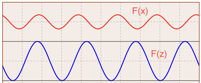

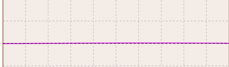

So you're saying that:
##f(x)\cdot f(z) = 0##

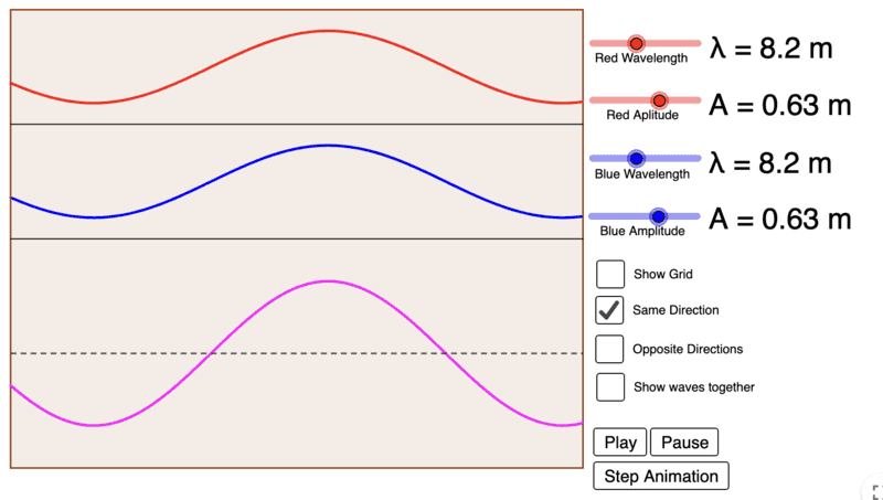

Sorry maybe I didn't understood, but isn't the purple wave wrong? It should be the superposition of red and blue.
Given two sin functions ##A\sin k_1 x##, ##B\sin k_2 x##, plot them and their product for some values. Notice only if k1=k2 is the product average nonzero
Sorry, maybe I don't get it. There are two equal waves, but they don't cancel each other
