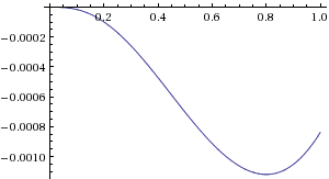

However, I tried a different constraint, noticing that the error grew as x→1. If I place a constraint specifically at x=1, I get [itex]\frac{1+a}{1+b}=z\Rightarrow 1+a=z+zb\Rightarrow -a+zb=z-1[/itex]. Ideally, it may seem that we want z=ln(2), but this is not actually always the best idea. As well, I had Z80 programming in mind, so I used a rational approximation of ln(2). Using continued fractions, I truncated to [itex]ln(2)\approx \frac{9}{13}[/itex]. Solving the system of linear equations, we end up with [itex]a=\frac{1}{8},b=\frac{5}{8}[/itex]. Indeed, the error is now much better at x=1, but the location of the worst error is now moved to about x=.8000, with an error of .001119998 according to my TI-84+.

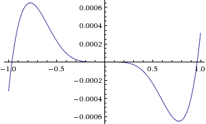

Similarly, we can derive for arctangent, using an approximation of [itex]tan^{-1}(1)=\frac{\pi}{4}\approx \frac{22/7}{4}=\frac{11}{14}[/itex]. The resulting values for a and b are then [itex]a=\frac{2}{9}, b=\frac{5}{9}[/itex] and the maximal error is smaller than [itex]\frac{1}{2^{10}}[/itex].

From Wolfram Alpha, the error for ln:
cd98f00b204e9800998ecf8427eflaol1tler&f=HBQTQYZYGY4TQM3EMI3WENBWGUYDCNBSHA3WGMZVG5RDMNJZMYZQaaaa.gif
And arctangent:
cd98f00b204e9800998ecf8427e979110drmj&f=HBQTQYZYGY4TOM3EMI3WENDEGMYDCNBSHA3WGNJZGBRTKNLBHA2Aaaaa.gif
