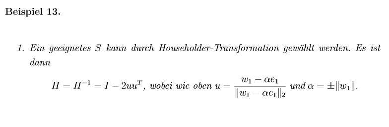

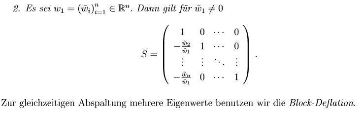

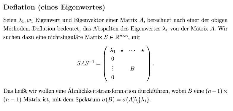

At the statement it doesn't say anything, but in some notes (in german) I found the following:
That's why I thought that we have to use the Householder transformation.
Ah okay, that is another algorithm to do a deflation.
Its input is also an eigenvalue and its corresponding eigenvector.
Can we apply it? (Wondering)

(We take at $\alpha=\pm \|v\|$ the sign so that the value of $\|v-\alpha\cdot e_1\|_2$ is big, this will be if $\alpha=- \|v\|$, right? (Wondering) )
We have that $$\|v\|_2=\sqrt{\left (\frac{4559}{675}\right )^2+\left (- \frac{851}{555}\right )^2+1^2}=\frac{\sqrt{22311331}}{675}$$
So, we get $$v-\alpha\cdot e_1=v+\frac{\sqrt{22311331}}{675}\cdot e_1=\begin{pmatrix}\frac{4559}{675}+\frac{\sqrt{22311331}}{675} \\ - \frac{851}{555} \\ 1\end{pmatrix}=\begin{pmatrix}\frac{4559+\sqrt{22311331}}{675}\\ - \frac{851}{555} \\ 1\end{pmatrix}$$
Then $$\|v-\alpha\cdot e_1\|_2=\sqrt{\left (\frac{4559+\sqrt{22311331}}{675}\right )^2+\left ( - \frac{851}{555} \right )^2+1^2}\approx 13.87$$
Therefore $$u=\frac{1}{13.87}\begin{pmatrix}\frac{4559+\sqrt{22311331}}{675}\\ - \frac{851}{555} \\ 1\end{pmatrix}$$
So, we have to calculate the matrix $H=I-2uu^T$. Do we have to calculate next the product $HAH^{-1}=HAH$ ? (Wondering)
Then, if I have understood that correctly, we get a matrix where the element $a_{11}$ is the eigenvalue $4$. But what do we do next? (Wondering)
Yes. That is also how I understand it.
The next step is simply to take the 2x2 sub matrix B, which is the result of the deflation.
That is, B should have the same eigenvalues as A, except for the eigenvalue 4 that we deflated.
So B should have eigenvalues -4 and -1. (Thinking)

Do we maybe apply the Inverse Iteration, i.e. we apply the power method for $(B-sI)^{-1}$, for some $s$, then we find the largest in absolute value eigenvalue of $(B-sI)^{-1}$ ? That would mean that this eigenvalue is the smallest in absolute value of the matrix $B-sI$ and then we add to the calculated eigenvalue $s$ to get the smallest in absolute value eigenvalue of $B$.
Are my thought correct? (Wondering)

I think we should pick $s=0$ and then indeed apply the inverse iteration algorithm.
The result should be an approximation of the eigenvector $\mathbf v$ that belongs to the eigenvalue with the least magnitude.
We can then find the corresponding eigenvalue by using that $A\mathbf v=\lambda \mathbf v\implies |\lambda|=\frac{\|A\mathbf v\|}{\|\mathbf v\|}$. (Thinking)
