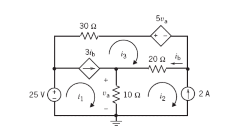

Given the circuit in the diagram I was wondering would I be able to make ib equal to the mesh i3.
I have the equation for my Super Mesh at i1 and i3 which is:
-25+30i3+5Va+20(i3-i2)+10(i1-i2)=0 (1).
The mesh i2 is equal to -2A (2).
subbing (2) into (1) gives:
-25+50i3+5Va-30i2+10i1=0 (3).
Va=i1-i2 (4).
subbing (4) into (3) gives: -25+50i3-35i2+15i1=0 (5).
subbing (2) into (5).
45+50i3+15i1=0 (6).
3ib=i1-i3 (7).
Now I almost have one unknown. Is it possible to set ib equal to i3 so i can isolate for i1 in equation 7. If i can't how would i be able to solve it.
Also, are the steps to finding the mesh currents correct for this problem?
ib is the current through the 20Ω (from right to left). I can see that resistor's current is composed of 2 mesh currents, I3 flowing R to L, and I2 flowing L to R.
Your eqn (4) is missing a 10, it's a 10Ω resistor.
The current through the 10Ω can also be equated to the sum of the currents into the node above it.

I am speaking of the two currents 3ib and ib.
What it is still missing is: i1=3*ib-i3 and since ib=i3+2 and ua=10*(i1-i2) you may reduce the first equation so that only i3 stays as unknown.
35+50i3+5Va+10i1=0 (3).
Va=10(i1+2) (4).
Va=10i1+20 (4)
subbing (4) into (3) gives: 135+50i3+60i1=0 (5).
3ib=i1-i3 (6).
ib=i3-i2 (7)
subbing (7) into (6)
3i3-3i2=i1-i3
i1=4i3-3i2
i1=4i3+6 (8)
subbing (8) into (5)
135+50i3+240i3+360
290i3=-495
i3=-99/58
I was wondering if i went wrong anywhere in my steps?

You made a sign error with respect to i2 in the red part above. Fix this and recalculate.
Well 20(-1)(-2)=40 and 10(-1)(-2)=20
So -25+40+20=35
where is the sign error
So -25+40+20=35
Never mind. I had a situation of poor visibility on my laptop, and the 35 looked like 85.
You're all good. i3 does indeed equal -99/58

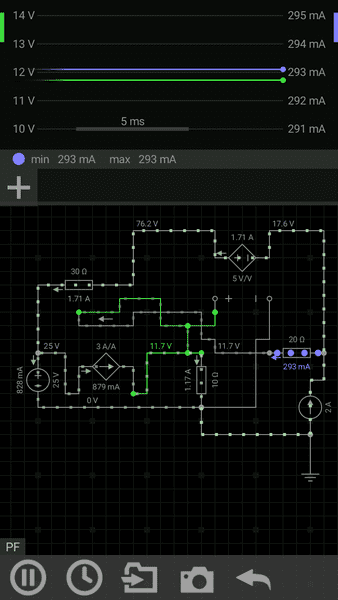

I ran it through a simulation, and the results agree with @The Electrician's solution.

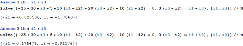

For any value of i1, a value of i3 = -27/10 - (6*i1)/5 gives a value of zero. However, this is only the solution to one equation, and not a solution to the complete network. It is also necessary to satisfy the equation 3ib = i1-i3, but you assumed i1=3*ib-i3, which is incorrect.
Here are two solutions:
Unfortunately, the second one is incorrect.
It has to be a conventional rule in order to state if i1=3ib-i3 or 3ib=i1-i3
since i1 and i3 are virtual [ghosts] but 3ib it is a concrete one.
Since I am only an engineer –master it does not help here, I think-and not a professor
I get the professors’ opinion.:smile:

The branch current 3ib is clearly composed of some combination of the loop currents i1 and i3.
The loop current i1 is in the same direction as the 3ib source current, and i3 is in the opposite direction, thus 3ib = i1 - i3.
Post #23 indicates that simulation gives the same result as assuming 3ib = i1 - i3.
