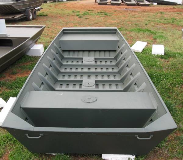

I wonder if this boat is like the 'trapeziums' the OP couldn't find.
It's wider at the top than the bottom.
Likes 1 person
