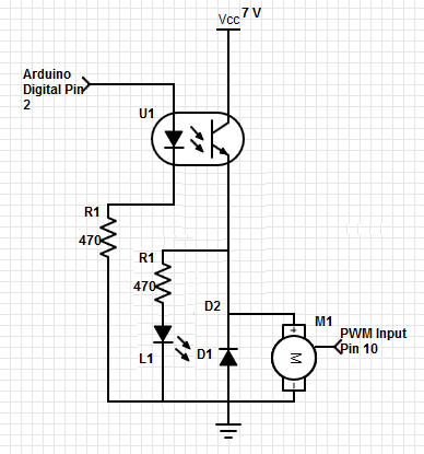

Hi, thank you for your help in advance.
I have a circuit configured as shown in this image. I got this arrangement from an earlier thread.
An arduino controls a DC solid state relay, and it works fine when my load is a simple LED. The arduino is controlling through a digital output header and using the digitalWrite() function, so I don't think PWM has anything to do with it. The arduino is powered by an external source: not USB.
Making that load a motor as shown in the image causes problems though. I have an LED in series so that I can see when the relay is closed and power is being delivered. It flickers at about 4-5 Hz I would say.
My relay is the CN024.
The relay is capable of delivering up to 3.5 A at 24 VDC. It is powered by a 7 VDC switched adaptor source right now. The power source can deliver up to 2 A. It is zero-crossing.
The motor it is powering is a simple servo motor. It is rated for up to 6V and typically draws 140 mA.
Despite this, is the flickering caused by a high current inrush and the circuit is being broken by a protective circuit in the servo? Though my knowledge is limited, it seems like all the requirements have been met: the SSR circuit is being closed, and there can be enough voltage supplied and current delivered. I tried putting a diode in series in order to drop the voltage from 7 V to (7-0.6)=6.4 V just to make sure the voltage wasn't too much.
Any ideas?Code included below, if it's important:

Resolved:
this issue was caused by a very bad power supply.
Your LED should be in parallel with the motor, not in series. You have an unnecesary series diode to the motor.
Attached is a revised circuit.

From servo documentation https://www.parallax.com/sites/defa...tinuous-Rotation-Servo-Documentation-v2.2.pdf
Power requirements: 4 to 6 VDC; Maximum current draw140 +/- 50 mA at 6 VDC when operating in no load conditions, 15 mA when in static state
(they don't say what is max loaded)
Power Precautions
Do not use this servo with an unregulated wall-mount supply. Such powe supplies may delivervariable voltage far above the stated voltage.
Do not power this servo through the BASIC Stamp ® Module's Vin pin, this can deliver voltages above the stated voltage. See the Board of
Education Connection Diagram below for jumper
settings.
Servo current draw can spike while under peak load; be sure your application's regulator is
prepared to supply adequate current for all servos used in combination.
good find, have fun!
Sorry, R1 must be moved to limit LED current, no resistor is needed with the SSR LED.
Attached revision.
