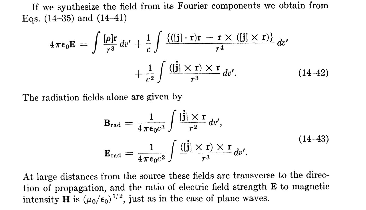

Deriving it it's too long to write here. In books like this:
Classical Electricity and Magnetism - Panofsky - Phillips - second edition
there is the complete derivation at chapter 14, at least for monochromatic waves. Here is the conclusion:
https://i.postimg.cc/05YyktpT/IMG-20181130-124007.jpg
The currents density j is proportional to the charges velocity, so its time derivative is of course proportional to charges acceleration.
This as answer to your question of relating radiation fields to the sources.
Concerning how to derive the equations I wrote in my previous post, again it's too long and in the Book cited here is made at the first two paragraphs of the same chapter 14. This is the conclusion:
https://i.postimg.cc/VNVtvc3B/IMG-20181130-125618.jpg
lightarrow
Likes rugerts
