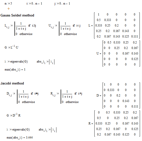

Here's my result for n=5 for the Hilbert matrix.
(This is the output of MathCAD instead of Matlab. ;))View attachment 1748
I found the max eigenvalue 3.4441 using the Jacobi method,and 1.0000,using the Gauss-Seidel method..

Now that I have made the calculations for the Hilbert matrix with the Gauss-Seidel method, I can see that the iteration matrix for the Hilbert matrix has a spectral radius approaching 1, meaning it also diverges due to rounding errors.
Looks like the same result then! (Cool)
