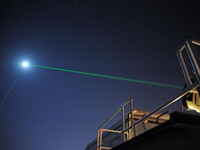

Seriously guys (mfb, Doc Al, Johnahh, et.al), what about this thought experiment:
  • Niels & Albert live on opposite side of the moon.
  • They communicate through moon-net IPv9 (very fast ~c).
  • Niels want to give Albert a nice birthday present on his 135 birthday, next year.
  • Niels are going to ‘sacrifice’ his old cat in this experiment, by throwing a birthday cake in his face.
  • This ‘glorious event’ will be streamed live to Albert over moon-net.
  • Niels has sent me an e-mail to fix the arrangement at the Apache Point Observatory Lunar Laser-ranging Operation.
  • Niels has sent Albert an e-mail to also look for “light phenomena” during the “birthday streaming”.
  • Niels instructions are that at 14 March 2014 we will send him 10 one second pulses and wait for one minute, and then send 10 new one second pulses, and then instantly point the laser at Albert.
  • Niels will throw the birthday cake at the cat at the 20th pulse.
Will Albert get* the laser ‘message’ before he sees the “cat-catastrophe” on the moon-net IPv9 “birthday streaming”?
What will Albert say when Niels claims he has given him an FTL-message as birthday present?
Will they quibble about this for another +30 years (or more)?
(there are gaps in this story but I hope you know what I mean)
:smile:
*Of course good old Albert has all fancy equipment needed for timing incoming signals at nanosecond resolution.
