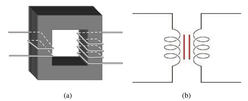

Hi, everyone. I just finished studying the principle on which a transformer works. It relies on Faraday's law of induction. And my high school physics book uses the following picture for illustration:
Roughly speaking, the core of iron is used to pass the magnetic field built by the primary coil to the secondary coil. But I found an interesting video clip on youtube that really confuses me:

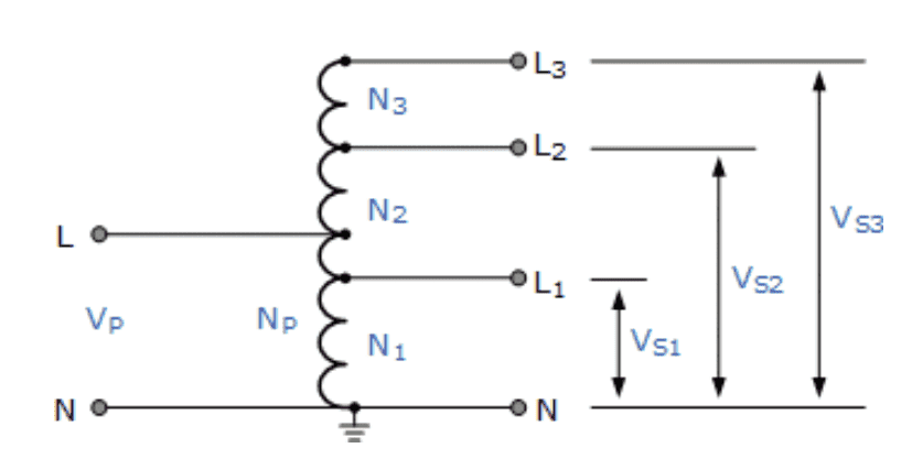

But even better, you should learn about autotransformers, where a portion of the primary and secondary coils are shared. Below is a depiction of an autotransformer with three secondaries.

An iron core greatly enhances the magnetic coupling between primary and secondary, making the transformer more "ideal". Air core transformers are difficult to design and too bulky.
Simple drawings make you believe the iron core might be redundant.

The iron is used in sheets so that currents won't be generated in the core material, just like they are in the windings. The insulation created between the sheets interrupts the current path that is concentric with the windings. Without this you'll have a very hot and inefficient transformer.
Other core materials deal with this in different ways. Powdered iron has lots of these interstitial gaps to prevent eddy currents in the core. Ferrites are highly resistive by nature since the ferromagnetic atoms are contained within the ceramics.

Post 6 is the right answer. Without laminations (i.e. with a solid version of the same core with the same core material) you would have Eddy currents. You should convince yourself that the laminations are arranged such as to prevent these currents by the electrical isolation between laminations
