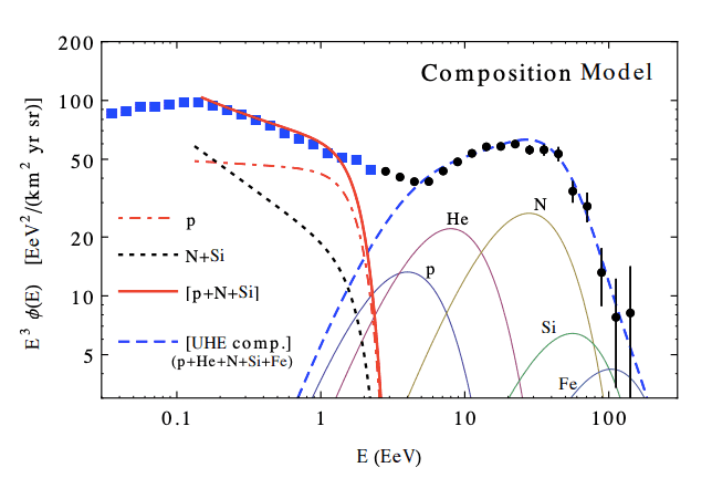

I had thought that cosmic rays were all protons, but this article says sometimes it's iron.

It appears they are composed of heavier nuclei in addition to protons, especially the highest energy cosmic rays. This graph from this paper shows that in order to fit the data, the authors need to assume that cosmic rays include many heavier nuclei, up to and including iron. However, be aware that these very high energy events are extremely rare. As for the paper you linked, why would we choose to colonize Titan as opposed to just living underground on the moon?
Likes swampwiz
