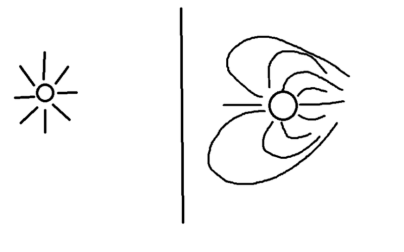

I recall that the path of light itself can be altered by gravity, then, being part of the electromagnetic force, then is it safe to assume that the paths of electric fields lines can also be warped?
I would imagine that the consequences would be enormous for electric flux in curved space.
For instance, the flux about a point charge is given by (1/4)(1/pi)(1/Eo)Q/r^2 by Gauss's law INTEGRAL[E * dA] take a sphere so the E field is tanget to the sphere and decreases at a uniform rate from the center, then you get Q/Eo = E(4pir^2), then solve for E.
However, if we're in a region of highly curved space, then the E field no longer retains its uniform rate of change from the center of a point charge. The flux lines would appear something like the picture attached below.
Eventually all of the flux lines would concentrate themselves at a singular point, as if the field of the point charge originated from two or more locations.
Or conversely, in a rapidly expanding area of space, which would be negatively curved, the E-field would then diminish even faster than 1/r^2, much like a dipole, which decreases at a rate of 1/r^3. In a region with a strong enough negative curve, the electric field about a point charge could reach zero over a finite distance (or possibly have reverse effects, an electric field under time reversal? Such as electrons attracting other electrons?)
Of course this sounds like a bunch of nonsense, but the Gaussian laws would suggest this given my current understanding, and thus my understanding must be severely flawed!

Yep, electric field lines are warped since the space itself is warped. One of the more interesting ideas I've seen is the idea that electrons themselves are a kind of microscopic wormhole. Electric field lines converge on the wormhole giving the sort of point particle behavior we've come to expect. Positrons would be the other end of the wormhole. :D The probelm I see with this view is that you still have a sort of electromagnetic field filling all of spacetime separate from gravity. Which I suppose isn't all that different from quantum field theory in which every fundamental particle has a unique field associated with it that fills the universe. Seems conceptually icky to me. Ideally, the electromagnetic field would itself be understood in terms of geometry.
Field lines work fine with General Relativity, and are a fine way to visualize electromagnetism. The tubes of the field lines are representations of anti-symmetric tensors, also known as a "differential forms", of rank 2, referred two as two-forms.
Elelctromagnetism turns out to be represented by a rank 2 anti-symmetric tensor, so it's a perfect match.
See for instance http://125.71.228.222/wlxt/ncourse/DCCYDCB/web/condition/9.pdf , "Teaching Electromagnetic Field Theory Using Differential Forms", IEEE TRANSACTIONS ON EDUCATION, VOL. 40, NO. 1, FEBRUARY 1997. This doesn't specifically talk about the usefulness of two forms with GR, but it does talk about using two forms to teach E&M.
Gravity turns out to be much harder - in general it takes a rank 4 tensor to represent it, and while it has a high degree of symmetry, it's not a differential form.
It may be easier to talk about EM fields not as "differential forms" but in terms of bivectors. The EM field is a vector field in spacetime but a field of oriented planes. The most natural way to think of this iis to take the electric field lines you know and extend them in the time dimension to draw out sheets. This is the natural object that describes the EM field, and boosting these planes is what gives the relationship between electric and magnetic fields.
This also explains why gravity isn't usually said to have field lines. The Riemann tensor isn't a bivector field like the EM field; rather, it's a linear operator on bivectors.
