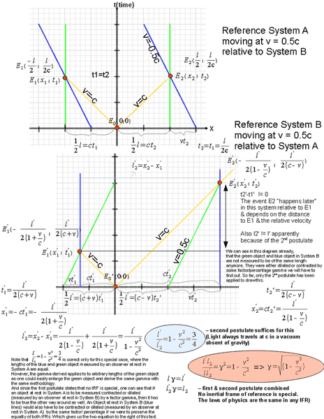

As to how i would prove that the Lorentz transformation formulas for the symmetric case of the astronauts would have to be involutions,
i would draw the two diagrams as i did here
...however, even though i initially intended to draw the symmetric case, i failed when drawing the diagram for System B.
For diagram B to be correct, the positive x-axis would have to become negative and vice versa. It would have to be flipped around the t-axis.
The scenario i drew, an observer A' at Eo' (0,0) at rest relative to the blue ruler/rocket would see an observer A at rest relative to the green ruler/rocket fly away of him towards the positive axis while A' is watching his back. Not a symmetric scenario.
Furthermore, to arrive at the most general case, i would have to start with diagram A having two differently sized rockets/rulers which would complicate the whole thing quite a lot.
If done right however, i believe that i would arrive at Lorentz transformation formulas which are involutions for both x, x' and t, t'
The easiest way to derive your revised LTs is to write the regular ones then note that you want to use ##x''=-x'##. You might also need to use ##-v## in the inverse transforms depending on how you define ##v## - I haven't thought that through completely.
Should you succeed in deriving the Lorentz transformation formulas which are involutions, you should see that if for example:
e1 x=5 t=10 , e1' x'=3 t'=11 and e1'' x''=1 t''=13 (again, fictive values), it won't matter if you apply the involution on e1 or e1' or e2'' you will arrive at the correct values as long as you use the proper vrel between e1 and e1' or e1 and e1'' etc.
following would be true:
x * <involution(<Vrel between e1&e1''>)> = x''
x'' * <involution(<Vrel between e1&e1''>)> = x
x'* <involution(<Vrel between e1&e1'>)> = x
x* <involution(<Vrel between e1&e1'>)> = x'
x'* <involution(<Vrel between e1'&e1''>)> = x''
x''* <involution(<Vrel between e1'&e1''>)> = x'
<involution(<Vrel between e1'&e1''>) would be a single function and would only depend on vrel
Your derivation will be based on two imaginary observers facing each other(or having their backs turned against each other) and moving relative to each other at vrel. It's a derivation between TWO systems, not three. Observers will never again have to agree on who is A or A' or A'' etc.
The transformations you are talking about are not Lorentz transformations in the usual meaning of that term. A given transformation of the type you are talking about is a Lorentz transformation plus a parity reversal. The parity reversal is required because each astronaut defines the direction "towards the other astronaut" as having the same sign, but these are opposite directions. Think of one astronaut trying to move into the exact orientation of the other at the instant they pass each other. He has to flip himself around to face in the opposite direction. The flip is the parity reversal.
So what you are proving (assuming your proof is valid; I haven't tried to check it) is that a Lorentz transformation + a parity reversal is an involution. However, there is a very good reason why these transformations are not included in the usual category of "Lorentz transformations": they aren't continuously connected to the identity. For example, suppose the two astronauts were at rest relative to each other. They would still be facing each other, so to transform from the frame of one to the frame of the other, you would still have to flip by 180 degrees, i.e., you would still have to do the parity reversal. This is not an identity transformation--it does not correspond to no change at all. But for two observers at rest relative to each other, the standard Lorentz transformation between their frames is the identity transformation--no change at all. This is a very important property for the group of Lorentz transformations to have, and your scheme destroys it.
So the problem with your scheme is not that it is incorrect mathematically; it is that it does not describe Lorentz transformations, it describes Lorentz transformations + parity reversals, which is a group of transformations which lacks a key property that the group of standard Lorentz transformations has.
The involution formulas i am imagining will be universal and will only require to be fed with the proper vrel between the TWO systems you want to transform.
Unfortunately i was sloppy in explaining the "facing" part.
The derivation for one of the symmetric cases will be astronauts facing each other as they approach each other and once they pass each other, they will of course have their backs turned against each other.
The other symmetric case would be astronauts having their backs turned against each other as they measure each other to be approaching from the negative x-asis and then when they just pass each other they will be facing each other, measuring each other to be moving away towards the positive axis.
No matter which of the two scenarios you solve for, as they are symmetric you should get involution formulas which whenever you apply them on an arbitrary amount of systems, as long as you use the correct vrel between the two systems you want to tranform the coordinates of, you should always arrive at the correct values.
No communication will be needed at all between any of the observers to decide who is A, A', A'' etc.
But your transforms can't be trivially combined. With the standard setup you can transform from frame A to frame B, from frame B to frame C, from frame C to frame D and from frame D to frame E, and you inevitably get the same thing as if you'd gone straight from A to E. Whereas with yours it depends which way round each pair of your coordinate systems were defined whether you'll get the same answer or the negative thereof. Unless you rotate your coordinate systems as necessary each time you consider a transform.
As I say, you can do this. But it's just making your life difficult in all but the most trivial of cases.
Edit: In addition to the points PeterDonis made, your transforms are not well defined in the case where ##v=0##. The astronauts aren't moving so cannot unambiguously define which way is forwards for them. Have they passed each other or not?
