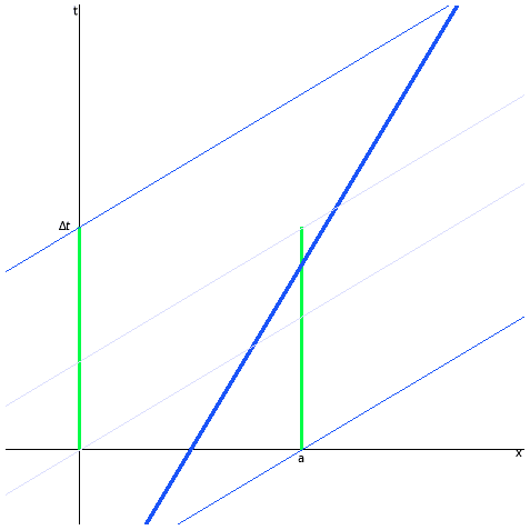

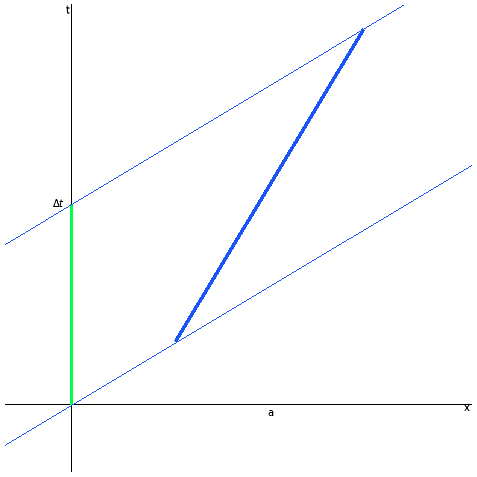

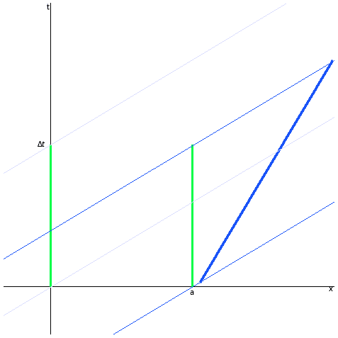

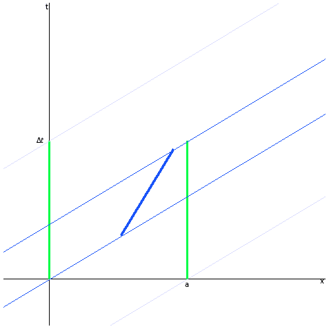

Here are some Minkowski diagrams to explain what's going on. All are drawn using the unprimed frame.
The first diagram shows a green line representing a clock at rest in this frame and located at ##x=0##. It starts ticking at ##t=0## and stops at ##t=\Delta t## and only this portion of its worldline is marked. There are also two fine blue lines showing the lines of simultaneity in the primed frame, and a thicker blue line showing a clock measuring the elapsed time in the primed frame.
If you were to compute the interval (the "length") of the blue line you would find that it was ##\gamma## times greater than the interval along the green line. This is time dilation.
Time dilation, indeed, does not care where you place the clocks. In this second diagram, I've added a second clock at ##x=a##, again ticking for the same interval in this frame. I've faded out the simultaneity lines from the first diagram and put in new simultaneity lines and a new blue clock. You can see (or calculate!) that it's the same length as the blue line in the first diagram - so again, this is time dilation.
So it doesn't matter whether you use a clock at ##x=0## or a clock at ##x=a##, nor where you place the blue clock that's at rest in the primed frame. The problems start when you try to use the left clock for the start time and the right clock for the end time. In the third diagram I've shown the simultaneity lines in the primed frame associated with those events and added another blue clock showing a much shorter time.
This is why your calculation fails, @Leepappas. It's because, when you apply the time dilation formula the way you are doing, you are assuming that the blue clock line in this diagram is the same length as the ones in the first two diagrams. It manifestly isn't due, as Orodruin says, to the relativity of simultaneity.
Just for completeness, here's the diagram if you use the right clock for the start event and the left clock for the end - this time the blue clock line is so long it doesn't fit on my scale.

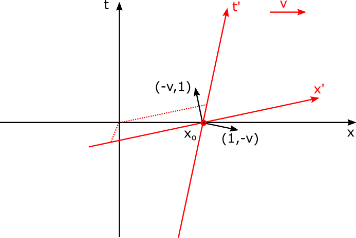

Leepappas said:
TL;DR Summary: SR just doesn't make sense.
Let's derive the Lorentz's transformation . The speed ##v## and the Lorentz factor ##\gamma=(\sqrt{1-v^2})^{-1}## are constant.
We need to express the coordinates of the same point in two coordinate systems.
For me, the most convenient way, is to use scalar product with a normal vector in order to calculate a distance from a coordinate axis.
[1] If we know ##(x,t)## and we want to calculate ##(x',t')##
\begin{align}
&x'=\gamma\left<(1,-v),(x,t)\right>=\gamma(x-vt)\nonumber\\
&t'=\gamma\left<(-v,1),(x,t)\right>=\gamma(-vx+t)\nonumber\\
\end{align}
Also ...
\begin{align}
\Delta x'&=x'_1-x'_2\nonumber\\
&=\gamma(x_1-vt)-\gamma(x_2-vt)\nonumber\\
&=\gamma(x_1-\cancel{vt}-x_2+\cancel{vt})\nonumber\\
&=\gamma \Delta x \nonumber\\
\end{align}
and
\begin{align}
\Delta t'&=t'_1-t'_2\nonumber\\
&=\gamma(-vx+t_1)-\gamma(-vx+t_2)\nonumber\\
&=\gamma(-\cancel{vx}+t_1+\cancel{vx}-t_2)\nonumber\\
&=\gamma \Delta t \nonumber\\
\end{align}
[2] If we know coordinates in the prime reference frame ##(x',t')## and we want to calculate ##(x,t)##
\begin{align}
&x=\gamma\left<(1,v),(x',t')\right>=\gamma(x'+vt)\nonumber\\
&t=\gamma\left<(v,1),(x',t')\right>=\gamma(vx'+t')\nonumber\\
\end{align}
Also, similarly as in [1] ...
\begin{align}
\Delta x&=x_1-x_2\nonumber\\
&=\gamma(x'_1+vt)-\gamma(x'_2+vt)\nonumber\\
&=\gamma(x'_1+\cancel{vt}-x'_2-\cancel{vt})\nonumber\\
&=\gamma \Delta x' \nonumber\\
\end{align}
and
\begin{align}
\Delta t&=t_1-t_2\nonumber\\
&=\gamma(vx+t'_1)-\gamma(vx+t'_2)\nonumber\\
&=\gamma(\cancel{vx}+t'_1-\cancel{vx}-t'_2)\nonumber\\
&=\gamma \Delta t' \nonumber\\
\end{align}
