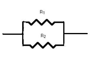

look at these 2 ...
can you see any difference electrically in the way they are connected ?now what about this version ...
what can you tell me about the difference compared to the first 2 variations ?
which resistors are connected in series and which are connected in parallel ?

There isn't a difference between how the first two are connected, no. But that's my point is that if you rotate the second picture you get the first one and that can be phrased as side by side (at least with general objects). So are you saying that in electrical circuits "side by side" always conveys the 3rd picture you posted (which is obviously in parallel)?
if the 2 ends of the components ... those resistors, or capacitors etc ... BOTH share a common connection
we call this a node. then they are in parallel
you can see that the top 2 images the side by side or one above the other is ONLY a drawing depiction of 2 resistors in series
they could be drawn as ...
but since they share only a SINGLE common node, they are still in series
D
