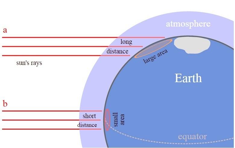

Hi! I have a question regarding the radiation coming from the sun. It might seem stupid to some people but I would really like to know how this works.
When you see images of the sun's rays reaching the Earth for example on this image from wikipedia (see attached image).
The rays are almost always depicted as lines with gaps between them. So is this just for illustrational purposes or are there actually gaps between the rays?
I don’t fully understand the processes behind solar fusion, but if you chose to see the energy exiting a fusion reaction in the sun heading for Earth as a photon/particle being shot away, then there must be a finite amount of photons for each reaction which would indicate that there must be spaces between the photons without “sunlight”?
And what happens if we chose to view the light as waves? There are a lot of different wavelengths comming from the sun but the wavelengths wouldn’t affect the size of the wave, just the length right? The size of both the electric and magnetic part of the wave is determined by the amplitude of the wave right? And in that case it should also be finite which could mean that there are holes/gaps in the radiation? And if this is the case, how big are these gaps, any way to put a number on it?
So In other words what I’m wondering is: If you have an extremely small light sensor and move it around a bit (but with the same angle of incidence to the sun) on a sunny day – will there be places where the intensity of the sunlight is much lower or maybe even zero? Or are the waves overlapping in such a way that the light density is 100% even all over the place?
No, this is not the way waves work. Rays are merely illustrative and showing the direction of propagation of the light.
The picture of rays is as you suspected just a picture, there are no gaps - and if you move a detector the illumination will be more or less uniform - this is true even if your sensor is smaller than the wavelength of the light you are detecting, or if you use a lens to magnify the image.
But why? The amount of waves/photons created in a fusion reaction should is limited right? Combined with a limited size of each wave/photon – how can there not be gaps?
And a follow-up question: If you google for example “why is it colder in winter than summer” a lot of the answers you find looks something like this:
“Its to do with angle of the sun. When the sun is high in the sky its radiation is concentrated over a small surface area. When its low in the sky the same amount of radiation is spread over a much larger area, so its much less concentrated and therefore less energy.“
But if there are no gaps in the irradiation, then that would mean that this is completely wrong. Because if you again look at the Wikipedia image and imagine that a surface is tilted 90° on the north pole, it would with this explanation receive exactly the same amount of irradiation as a surface with 0° tilt positioned on the equator right? And as those of us who live far north of the equator knows from experience – that is obviously not the case. So what is the correct answer? Is the ONLY reason behind why it is colder in the winter/at northern latitudes that there is more atmosphere that the sun needs to pass though? Is the whole concept of “radiation spread over a larger area” false?

Orodruin said:
No it does not mean that it is wrong. It simply means that there is a certain amount of energy per transversal area. A tilted area represents less transversal area and therefore less energy per unit area than an area which is orthogonal to the direction of propagation.
I understand that if you tilt a surface away from the direction of the sunlight the energy per area unit will decrease. And that is what I’m saying – this explanation doesn’t work when explaining why it is colder in the winter than summer, because a 90° surface on the North Pole is just as orthogonal to the direction of propagation as a 0° surface is on the equator! (well maybe it can explain why the ground on the north pole which isn't orthogonal to the sunlight is colder, but not for example a solar panel or a house façade)
Yes, but you cannot think so locally. If you put a 90 degree surface somewhere on the North Pole, it will cast a shadow on the rest of the North Pole and no energy will be deposited there and when the energy is averaged over a reasonably large region (as temperature tends to do) you will have less energy per surface area.
So do you agree with me then that if we imagine a completely naked Earth with no trees or obstructions. One solar panel 0° on the equator and one 90° on the North pole. Any explanation to why they are producing different amounts of electricity that involves the angle of the sun somehow spreading out the light intensity would be 100% wrong? And this would simply be a matter of different atmospheric thicknesses?
