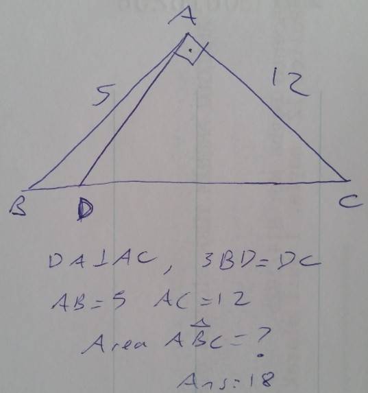

what is the area of triangle ABC in the attached? answer is 18
i can not construct any similar triangles here. all i can see is area of ACD is 3 times area of ABD but how does it help me...
How about extending AC to E such that ACD is similar to ECB?

i see... thanks !
