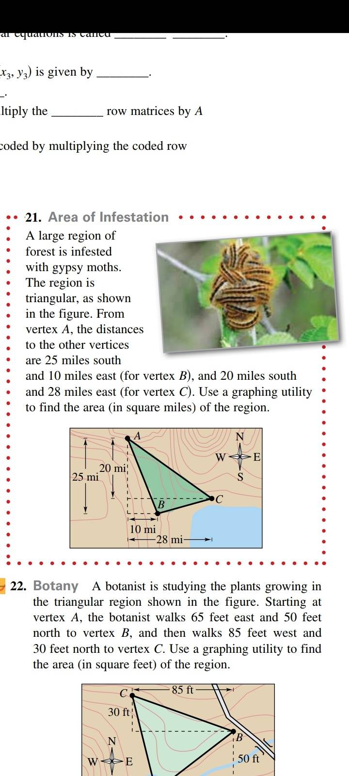

Hello everyone. I am having trouble finding the area of the shaded region using the determinant area formula. I know where to plug in the numbers into the formula. My problem here is finding the needed points in the form (x, y) from the given picture for question 21.

problem 21
let point B = (0,0)
A = (-10,25)
C = (18,5)
area of the triangle is half the area of the parallelogram formed by adjacent sides BC and BA which may be found using the cross product of two vectors ...
area = $\dfrac{1}{2}(\vec{BC} \times \vec{BA}) =
\dfrac{1}{2}\begin{vmatrix}
\vec{i} &\vec{j} & \vec{k}\\
18 & 5 & 0\\
-10 & 25 & 0
\end{vmatrix}=
18 & 5\\
-10 &25
\end{vmatrix}$

I don't need help with 22. I just need the set up for 21.

Can you tell me how you came up with the elements of the determinant?

Alternatively,
Vertices: (0, 25), (10, 0), (28, 5)
Area = $
\ 0& 25&1\\
10 & 0 & 1\\
28 & 5 & 1
\end{vmatrix}$
https://www.physicsforums.com/attachments/311846._xfImport
The area should be clear to you from this diagram.
If it's not then you really have a big problem.
