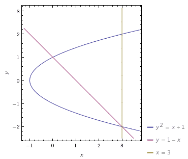

Ok. Let me put in a picture then.
You integrated the upper-right area in the parabola, which is also bounded by x=3.
But the lower-left area inside the parabola is needed.

In your initial integral, you took $y=\sqrt{x+1}$, which is the top half of the parabola.
And you subtracted $y=-x+1$, which is the line, that now counts as the bottom.
Then you did so for each x between 0 and 3.
This is the upper-right part inside the parabola.
In your second, correct, attempt, you took $x=1-y$, which is the line, which now counts as the boundary on the right.
And you subtracted $x=y^2-1$, which is the left part of the parabola.
This is the proper bottom-left part inside the parabola.
