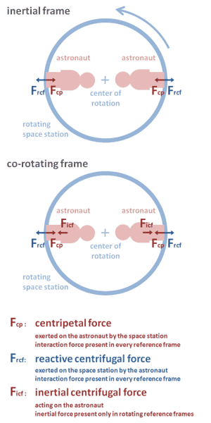

And here a picture I once made about a rotating space station:
@A.T..thanks for the diagram.Now, Iam a little confused about all the forces concerning rotational motion. I want to test my understanding of inertial centrifugal force again. Now a body 'A' is moving around a point 'O' in circular motion with a constant velocity 'v' and radius 'r'..
In the rotating frame of reference of 'A', there is centripetal force..But the linear velocity and angular velocity is zero..This contradicts Newton's second law because the body is at rest though it is still acted upon by centripetal force..So, we have to assume a pseudo-force called inertial centrifugal force which has the same magnitude of centripetal force and acts in the opposite direction on 'A'..Thus the net force on the body is zero and the body remains in rest..
Yes, this is the whole idea behind inertial (aka fictitious, pseudo, apparent) forces: Make Newtons 1,2 Law work in non-inertial frames. But you cannot make the 3 Law work for them, only "real" interaction forces are part of 3rd Law pairs. Therefore the inertial centrifugal force Ficf is not a reaction force to anything, and it exists only in the rotating frames. The centrifugal reaction Fcfr is a "real" interaction force that exists in any frame.

I like this diagram.
The only problem is if someone asks about the space station wall and sees only one force present on that wall they might be tempted to ask why is the wall not accelerating out. In the inertial frame diagram.
Would you then go on to explain there must be a force between the wall space station atoms that is larger that the force of the astronaut on the wall of the space station and directed in?
Yes, there are obviously internal forces that hold the space station together. There are also internal forces in the legs of the astronaut, which prevent his upper body from hitting the wall. But drawing all the internal forces is hardly possible.

I think that frictional force between the astronaut and the space station may also contribute in some way to the internal force...
If the angular velocity is constant, and astronaut doesn't run along the walls, there should be no tangential friction, just radial contact forces.
Can these contact radial forces act as centipetal force?
Yes, the force by the wall on the shoes is centripetal.
