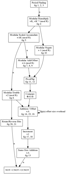

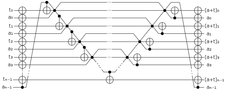

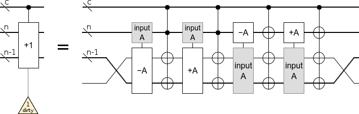

I've been working on a paper that explains how to implement Shor's algorithm from top to bottom using 2n+1 qubits (w/ n-1 in an unknown state that must be preserved) (the previous best was 2n+2 w/ none in an unknown state). Here's a few diagrams from it.
The fact that the exponentiation is calculated under superposition doesn't really matter at all. All the arithmetic can be done with classical reversible circuits. There are some optimizations made possible by quantum gates, and of course the very top level has some quantum stuff, but all the arithmetic really is just standard classical reversible stuff.
An adder (not novel):
Incrementing (novel):

Transitive reduction of the dependency graph between constructions:
As that last diagram shows, there's a rather lot of constructions on the path from exponentiation to Toffolis. But they all basically look like the diagrams I showed: take what you've built up so far, and combine it to build the next thing.
