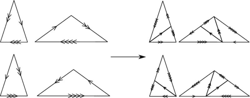

This is amazing thank you very much.
These rules are the same local rules of Penrose tiling. No wondering the number 5 pops up.
You are correct that the cycle size of five seems to be consistent. I had not expected that.
