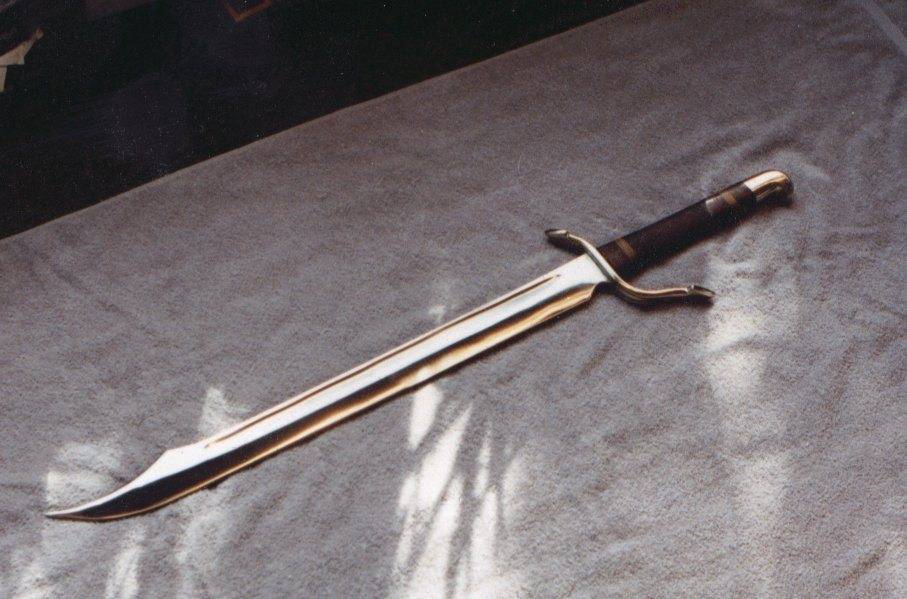

Swords are actually more like a narrow mace when dealing with nearly any kind of armor. Most of those swords did not have a sharp razor edge like we would tend to think, the edge that took the least damage to the sword and still did the damage to the enemy was closer to the shape of a cold chisel.
Note, I was a swordmaker myself and built medieval armor for historical reproduction groups, and working with the SCA where armor is a specific for of safety equipment. So I actually have a LOT of experience in this area. I worked under the name of Steelwolf Armourie, but since am disabled am no longer able to DO such work, but I can most certainly advise on this subject, which comes up frequently, in actuality.
Most of the cutting idea for swords is the later period Japanese Katana, Persian Samshir and the Euro-American Saber and those were designed for gun era with no to cloth armor. Katana was built to cut bamboo and silk armor.
All the swords before them sere either long crushing weapons or a shorter thrusting weapon. The underarm thrust likely to do more lethal damage with a bronze sword than trying to do a slash and slash just cuts surface material, a thrust goes to the vitals. The sword is still not able to go nearly as fast as the bullet (even blackpowder musket is faster), and so is not able to attain the same kinetic energy

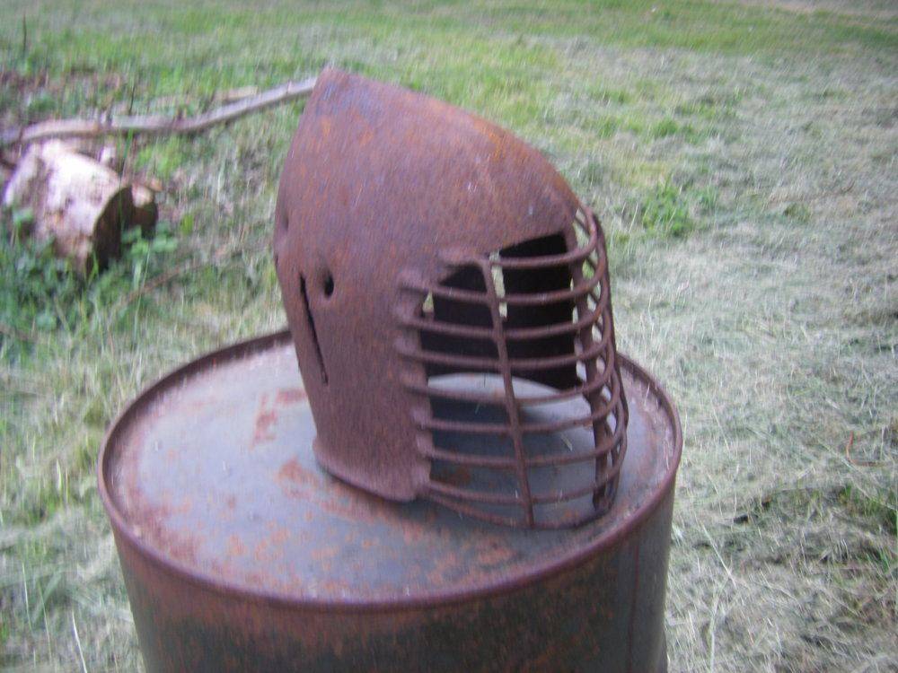

Also built a Great Helm for a gent, but it was Too Great a helm for him to actually wear and use, even though I had built it to the man's direct size and dimensions demanded and of the 12 ga steel he wanted (which the other armorers looked at me with wonder at hammering a full helm out of 1/8 in steel) but it was too much, would pull him off his feet, even though it gave him all the protection he could want, he could not Move with it. So, I took it as a learning experience (after a little bit of explanation that we are building safety equipment for a full contact sport, so us armor's have to know better than the fighters what they really need.
That was at a very dry event, no open fires allowed. and that night it poured rain, got cold etc, and nobody had prepared for that since it was high summer and bad fire season. Well, I got under my big canvas Norse A-Frame stype pavillion, and looked at fire pit, and helmet, fire pit, helmet...took a piece of 18 ga and bent corners to form a lid, and then used the huge pinecones and small branches all over, very dry, and cleared proper circle, put the huge helm upside down in the firepit and started a nice blaze, covered it with the 18 ga so it was not an open flame, open grillwork on the face, and the edges of the top, but it was a safe-contained fire (I was Navy Firefighter and so am super cautious about such) But ever since then I have kept the Helm Fires Burning!
That is on top of a 55 gal drum, for scale. 1/4 in bar for horizontals. I did later cut slots in the sides for even venting, but before that I took a battle-stype pick to the sides of it, to see the damage for myself. Part of why I KNOW this stuff is because I DID it, this helm is from over 30 years ago, but close to that age.

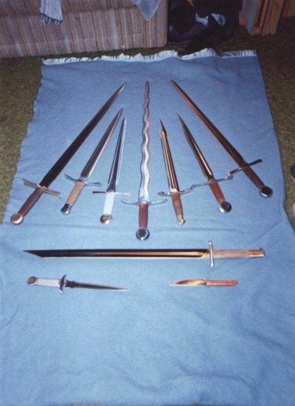

The lower is the Spanish Badelier, nasty piece of work, that. And above that was a 10 day run of work for me and an apprentice, Elena, who was learning the machining and setup side of the business, I was teaching her how to build swords right along with me and was doing well, and then my health came apart rapidly.
Edit: All of the work was done to tool quality unless otherwise asked, such as some props for conventions etc, or specific fencing type of gear. All fully hardened and tempered, heavy tang construction with permanent construction. No pommel screwing off, etc. But being disabled, the best I can do is to teach others about it and to help folks understand some of the realities behind it all.
