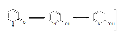

Hi everyone,
I've recently had a little discussion at work concerning the concept of aromaticity applied to some molecules.
To cut a long story short, while I see why 2-pyridone is considered aromatic:

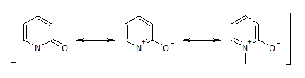

I don't understand why 1-methyl-2-pyridone is also considered aromatic:
The two structures on the right do respect the rules for aromaticity (6 pi electrons, cyclic delocalisation, etc).
However, if a molecule must be seen as the average of its resonance structures, 'weighted' on their relative stability, then a molecule whose only aromatic resonance structures are very unstable (e.g. by charge separation as above), will be represented more closely by non-aromatic structures, and on the whole it won't 'be' aromatic. Or am I wrong?

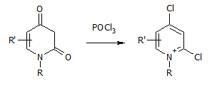

To add to the confusion, in the past I did a chlorination of a fused pyridine-2,4-dione, which gave this:
We expected the chlorination to go only once on either carbonyl, yielding 2 isomeric mono-Cl products, and instead we got the dichloro compound with a positive charge. The justification was that the latter was more stable than expected due its aromatic character. It was so stable that it took a rather long time to hydrolyse off one Cl at pH 10 (large excess of aqueous carbonate). And we could even isolate it as a solid salt.
This fact is used as an argument to say that charged structures are perfectly valid.
But for me this is a different case, as here there is no *separation* of charge, and all resonance structures have one positive charge on one atom, there is no possible structure with no charges anywhere.
So... not clear at all, as far as I'm concerned.

The top figure doesn't present a proper resonance structure as it involves the motion of a proton from the nitrogen to the oxygen (this is called a tautomerization). If you were to draw the resonance structures without the tautomerization, you would have resonance contributors with a separated positive and negative charge. Aromaticity does not rely on having a structure with alternating double bonds like benzene. The resonance structure of pyridone with a double bond on the oxygen is still aromatic. All it requires is a series of atoms bonded in a (planar) cycle where each of the atoms in the cycle have a p-orbital that it can overlap with the p-orbital from its neighbor (along with the 4n+2 electron rule). Another good example of a molecule that exhibits aromaticity without looking anything like benzene is thymine.
Hi Ygggdrasil, thanks for your reply.
I did tautomerise 2-pyridone to 2-hydroxypyridine intentionally (as you see I used reaction arrows for the first transformation, and the electron shift arrow + square brackets notation for the other two), because I thought the ability to tautomerise to structures with fully sp2 cycles was part of what made a chemical entity aromatic.
So from what you say I understand that instead I should keep the original pyridone structure and only shift electrons around, when trying to assess aromaticity.
If this is the case, then one would say that 2-pyridone and 1-methyl-2-pyridone have a similar degree of aromaticity, whereas 2-hydroxypyridine is more aromatic because all its predominant resonance structures are already aromatic and don't require charge separation.
Would you agree with this interpretation?

I would not say that 2-pyridone is less aromatic than 2-hydroxypyridine. Because they differ by an intramolecular proton shift, any solution of 2-pyridone will exist in an equilibrium between 2-pyridone and 2-hydroxypyridine. This equilibrium has been measured, and it suggests that 2-pyridone is 0.3 kcal/mol more stable than 2-hydroxypyridine (http://www.chem.wayne.edu/schlegel/Pub_folder/54.pdf). If 2-hydroxypyridine really experienced much more resonance stabilization than 2-pyridone, we would expect 2-hydroxypyridine to be much more stable than 2-pyridone, but this is not the case. Rather, the relative basicity of the nitrogen vs the oxygen determines which tautomer is more stable, not their relative aromaticity.

Thank you both for your replies.
I think I understand what you mean. It was the ucla tutorial that made it clearer.
Basically, what I considered to be separation of charge is actually just a way the molecule has to put its electrons in the orbitals that make more sense energetically.
I was well aware of the sp3 to sp2 transition for the heteroatoms of pyrrole, furan, thiophene, which allows two 'usually' sp3 electrons to become part of the aromatic cycle, and I saw this process as 'normal', because it didn't require any bizarre charges to appear.
Turning the pyridone sp3 NH into sp2 was also 'OK' (as if it were a pyrrole NH), but then I was still counting one electron for each C=O group, the one on the carbon, which meant the cycle couldn't be aromatic. The only way I could get that electron out of the way was to place it on the oxygen, thus going from C=O to C+-O-, i.e. a separation of charge.
I now seem to understand that this is not necessary for Huckel's rule. The tutorial specifically mentions that such electrons must not be counted. It doesn't really explain why, but OK, I suppose people have thought about this.
Based on the above, the next question would be, if the C=O electron that should be on the carbon actually isn't in the aromatic ring, it must still be somewhere (closer to the oxygen?), so does that mean that the carbonyl oxygen is more electron-rich than it would be in the corresponding lactam (i.e. in valerolactam?). And would the ring then be just as electron-rich as in a pyridine?
That would be strange, because we know very well that 2- and 4-pyridones are more reactive than the corresponding pyridines in electrophylic substitutions.
As DrDu seems to suggest, this may just be a byproduct of the fact that I was taught organic chemistry using mostly the VB theory. Molecular orbitals were considered witchcraft back then :O)
So perhaps all these electrons are going just wherever they want, enriching one atom or the other in ways that are inscrutable to the non-quantum-physicist, and there's no point in learning silly arithmetic rules or playing with doublets and charges anymore. :O(

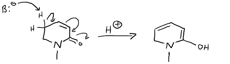

In the case of my 1-Me-2-pyridone-like molecule, should I expect it to be much more stable than the analogue where the double bond in 5,6 is hydrogenated, i.e. this:
By looking at the molecule on the right, I would call that a Michael acceptor, whereas I would not expect that kind of behaviour from the one on the left, simply because of the electron-donating ability of the nitrogen.

At first glance, I'd agree with your assumptions about those two molecules. Of course, it again boils down to what exactly you would try to react them with though. I can imagine the molecule on the right being difficult to actually act as a Michael acceptor unless the solvent and nucleophile were chosen carefully. You'd still probably have a decent chance of simply deprotonating the carbon at #5 as shown below:
You end up with a wonderfully aromatic product.
