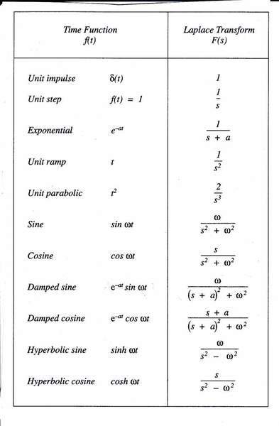

Absolutely, i have a step input of 0.01v and my other values are R=100ohms L=0.5henrys and C = 0.001 farads. I am trying to understand this function
$$G(s) = A \cdot \frac{1}{s^2 + \frac{1}{\tau}s + \omega_o^2}$$
It looks similar to functions from the table I'm working from (I've attached it) could you show me which time function from my table i need to aim for? Then i should do partial fractions before inverse transforming to find the transient response?

I chose the variable names ##\tau## and ##\omega_o## because they happen to have relevance to the problem at hand. I happen to recognize the form of the transfer function and the type of the differential equation it "belongs" to, so I suppose I had an unfair advantage there :smile: However! You can use whatever variable names you wish, or pick them out of a hat if you like. The mathematics will be the same. ##\tau## is generally used to denote a time constant of some form, and can appear in a damping term. ##\omega_o## is usually the natural frequency of a system that is prone to oscillations.
I'm afraid you'll be looking at damped sine and cosine here... sorry about that! If you haven't done any examples or problems with them yet then I think that this problem is a bit of a nasty way to get introduced to them.

"Will the roots be real or complex?" complex... so in this scenario I should multiply out the denominator of the damped sine function to s^2+2as+a^2+omega^2...find my a and omega values, then partial fraction (remembering to add in the b/s from earlier) to form the damped sine and cosine functions?
Many thanks
Many thanks
Yup. That's the plan.
